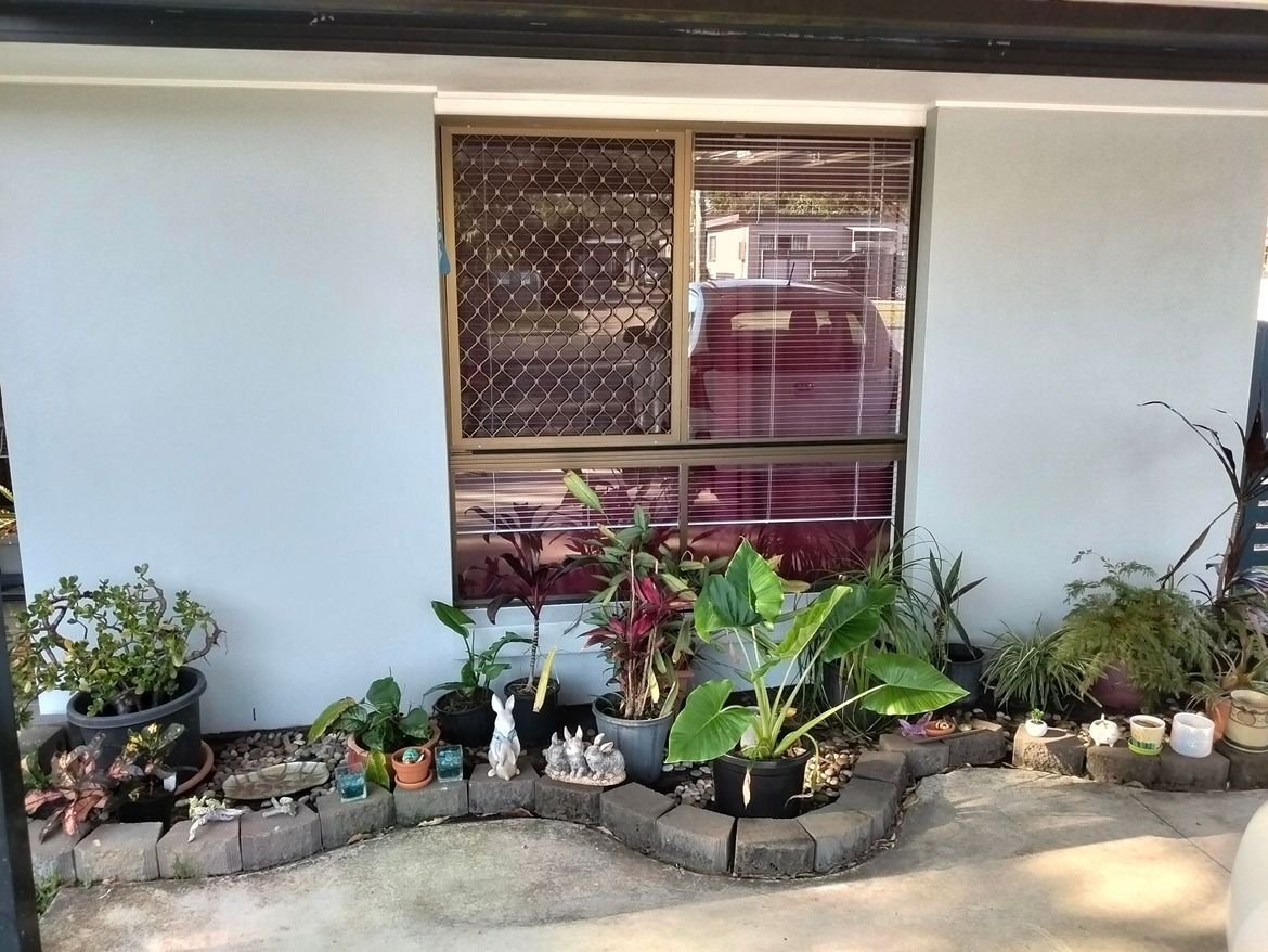

Hello
My house has a slight negative grade from the street so I need these blocks here to help keep water away from the house but they're so ugly. The garden bed is set on a concrete driveway.
I saw your merbau garden border roll which looks good but what I'd really like is a bendable small white picket fence. Failing that the merbau would be fine.
Would either of these be feasible and if so, how do they actually attach to the blocks? I don't want to remove the blocks; I just want something in front of them so it looks nicer. Would appreciate any suggestions. Thank you.

Hi @LorenClayton,
The closest thing I could find to a white picket fence is this Matrix 890 x 290mm Picket Garden Edging. They would be somewhat flexible, but unfortunately, I doubt they would be flexible enough to follow the bends in your current edging.
With this, I think using the Merbau Tapered Garden Border Roll, and painting it with 2-3 coats of exterior paint would be a great way to go.
You could attach them to the blocks with an adhesive such as this Liquid Nails Landscape Adhesive, or by predrilling the blocks, installing masonry plugs and then screwing them on. Either option would work, with a combination of the two being the best option.

Hi @LorenClayton,
I am trying to think of a way to use the Matrix Picket Garden Edging.
The edging may have enough pliability so when it is cut half way through at the front it can be bent to confirm to the edging profile.
If that's the case try and make the cuts align with the block joins.
If that doesn't work out cut block width sections and for this and the above use Liquid Nails Landscape Adhesive as recommended by @JacobZ.
You could visit your nearest Bunnies and buy one length to try out the above suggestions.
