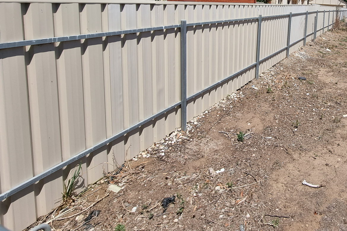

I have to say that this is one of the most interesting fences I've seen. A self-supporting fence with no posts visible. I suspect that it either has the post support integrated with the panel or it is very cleverly hidden. If you look at each panel you'll notice that every panel is attached by a screw which leads me to conclude that either one or two of the panels travels deeper and acts as the post for the assembly.
Attaching an extension to this type of fence is a bit tricky since there is no safe spot for you to drill into without having the other end of the screw exposed. Is this a double-sided fence? Would it be possible for you to post a photo of the other side of the fence so we can see how the screws were covered or installed without the sharp points being exposed? If we can see how it was done, it might be possible to duplicate the mounting style which will allow you to attach an extension.

The back of the fence down the driveway is below, though the fences we share is set up the same.

Thank you very much for posting those photos of the other side of the fence. That solves that mystery, I originally thought that the fence was self-supporting, but those steel posts and horizontal rails gave away the secret. The ideas you've proposed are all very sound, I suggest measuring the depth of the grooves so that you'll have a better idea of how deep the timber needs to be.
It's difficult to guess how deep the current metal posts are, however, the extension set you're planning to use is not that heavy, but when taken together as a whole will definitely add weight to the fence structure. If you are planning to mount the extension to the horizontal rail make sure to use enough screws so that the timber can carry weight and withstand strong winds.
Your other suggestion of putting up posts guarantees that the existing fence will not be affected by the extension. It also serves as a mounting point for timber or decorative panels should you wish to cover the Colourboand fence in the future. These are all excellent ideas and I leave the choice up to you. I vote for putting up the posts, have a look at this discussion as to why - Merbau panel screening by @WendyL. If the finances are a bit tight you can update your fence piecemeal as your budget allows, but the final result will look fantastic.
