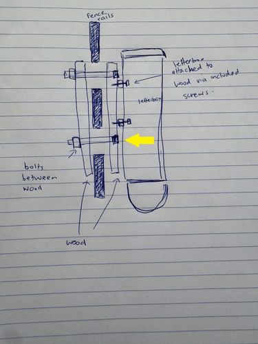

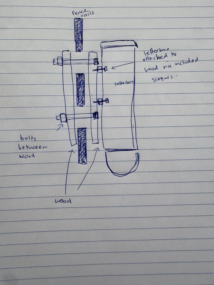

So instead am wondering about a design like pictured with 2 bits of wood on either side of the fence bolted together and then attach the letter box at the front to the wood.  I appreciate the wood would need cutting to size and then be stained or oiled to protect from the weather. But not sure if this is the  best option or exactly what I will need to buy to make this possible (and hopefully not have it look like a 10 yo's woodwork disaster). Although also happy to do something quick and easy that would be hidden behind the letter box and last long enough to perhaps do something a bit nice later on when my DIY skills have improved. I have very limited tools and no power tools so absolutely will need to borrow/buy somethings for this but not 100% sure what to get. First time home owner so suddenly have to start accumulating kit and skills to do all the maintenance around the house so ideally like things that will be useful in the future - not just for a single job now.

Hi @docjill,
I suggest you drill another set of holes in the letter box.
With the top holes aligned mark and drill another set of holes so they clear the bottom of the rail.
