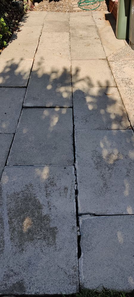

I want to get rid of a trip hazard from uneven concrete.  Can I just use any sand and cement with a primer?

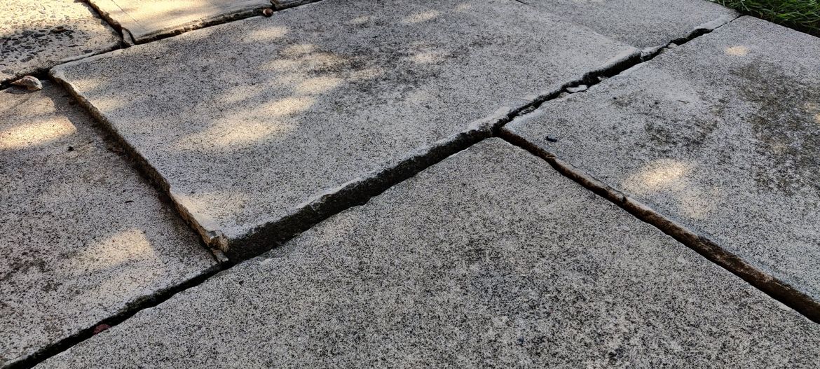

Thanks for the quick reply.  I originally ordered the Lanko 136.  When it was delivered I didn't think it would be enough.  I exchanged it.  I spoke to my builder friend.  He said to get floor leveller.  I later watched a video but it didn't seem right.  I returned the floor leveller but they ran out of Lanko 136.  I saw Dunlop 5kg Ardit Rapidset Repair Mortar which seemed to be the same stuff so I bought it.  Now I notice there is Dunlop 5kg Floor Repairer Rapid Patch Mortar. Should I get the Lanko 136 or will one of these do?  Which one?  Also, do I need primer.  I bought 5L because it was better value. The total area is 20 square metres but not all of it needs to be levelled. The biggest gap is 3cm height.   I am so confused.

@petkorazzi,
These would be considered large pavers, which are more fluid than a fixed stationary slab. There's continuous movement, whether that is from subsidence or tree roots pushing them up. Any repair you do with a solid mortar, grout or cement will crack the next time they move. What really needs to happen is that the pavers get lifted, the issues are addressed, the ground is levelled and compacted, and then they are re-laid.
My hesitation in recommending a product is the same reason we don't use cement between pavers. They move, and the cement cracks. If you were to use a mortar or grout and a primer, I'd expect to see the repaired area fail sometime in the future. Using a self-levelling product might work, but it will be prone to the same cracking issues.
