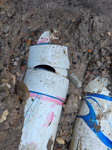

How to fix broken stormwater pipe?
This stormwater pipe was broken during a post installations, looking ways to fix it properly by replacing this 15 degrees 100mm bend.
Any suggestions and instructions would be welcome please.
Re: How can I fix this pipe
Hello @jaglan
Welcome to the Bunnings Workshop community. It's sensational to have you join us and thanks for sharing your question about your stormwater pipe.
Just a friendly reminder that any plumbing work must be carried out by a licensed plumber for safety and compliance.
It's possible that the plumber will cut the broken elbow off and use a Holman 90mm PVC Stormwater Slip Coupling in combination with a Holman 90mm 15° Male And Female Storm PVC Elbow. They will probably use some form of adhesive such as the Protek 125ml Type N Blue Cement Solvent to join the pipework together. Doing a test fit is always practical before gluing everything together.
