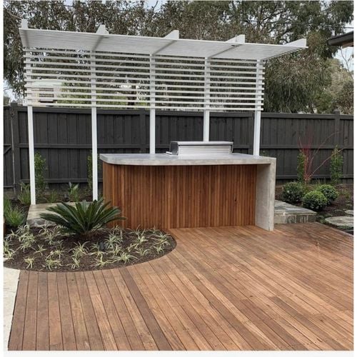

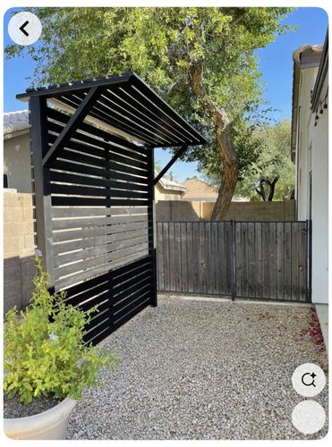

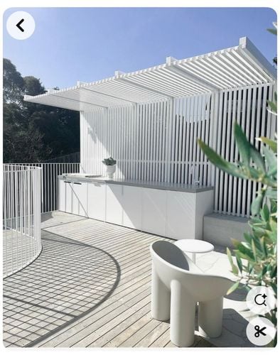

pictures for example of what I want to build.

Do you mean if I did the structure as an L shape and no cantilever and had the supports as per the photo of the black screening, the 800mm hole would suffice?

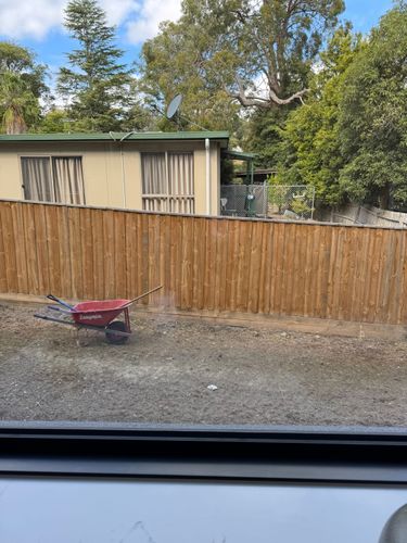

Here’s a photo of my 2.1m fence from my kitchen window where I am wanting to put the screening.

The first two screens look to be made of aluminium, which is lighter than timber, meaning it can work without the diagonal bracing. If you're using timber for the overhang, then you will more than likely need some diagonal bracing to support it, regardless of the depth of the footing.
As the rule of thumb is one-third the overall height of the post in the ground, you should definitely aim for them to be as deep as possible.

To describe the L shaped structure I was thinking of. Will use the wheelbarrow as a point of reference. And we are looking from top down at your yard from above.
From the red wheelbarrow come towards the photograher by a meter (this is the short part of the L)
From the red wheel barrow go along the fence the 3m you want (This is the long side of the L) I would actually go 4m or even a bit more so there is a good overlap as it will make it easier on the eyes for your side.
The Short side of the L (red wheelbarrow towards you by a meter will act as a brace to steady the privacy screen, whichin turn means you could have that cantilever you mentioned.
If you need a sketch I can do one tomorrow :smile: Just let me know.
