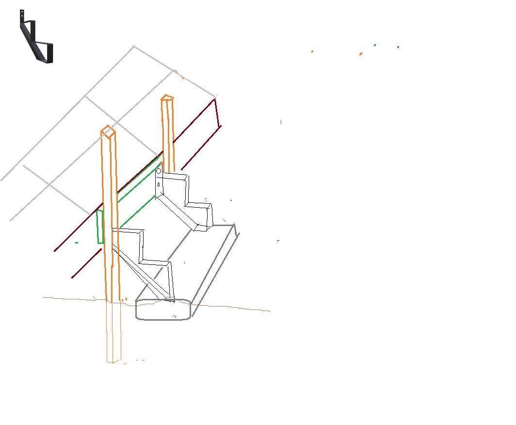

Steps  take a pounding  so any stair stringers will have to be bolted to a solid structure under the cement sheeting.
Or you can buy steel or  timber strings and attach them to posts in the ground beside your decking making them free standing .
Freestanding stepsFreestanding steps

Thanks for the reply @Jewelleryrescue!  This is more of the build I'm looking to do though - except slightly higher drop and length.  Thanks for the tip on the rust tho... these are actually the house footings - only 6 years old 😬.  I'll maybe check with a builder and possibly QBCC.

I like your planned full length step the hardware I proposed you use can still  be used to make your  full length step modified  slightly.  and the posts trimmed to a usefull height under the boards  Or that video will show you another way , :smile:
