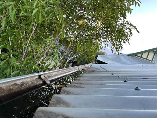

The water is accumulating at the opposite end from the down pipe so I’m very sure the gutter is having the wrong slope (I took a photo to show it). How do I adjust the slope/ gutter bracket? Is it a job that’s possible for me to tackle it myself?

That appears to be a great deal of water sitting in the gutter, much more than what a correct fall would drain. It's a bit hard to tell, but it looks like halfway along the gutter length it has sagged. This could be causing the water to pool at the far end. If this is the case, simply raising the middle bracket might correct the overall slope, fixing the issue.
If the lowest point is not the middle and all this water is sitting down at the far end, then it looks like the gutter might have dropped at that end past horizontal. Even if there was no fall and the gutter was parallel to the ground, it still wouldn't fill up with water as it appears to have in your image.
To increase the fall, you would remove the guttering from the clips, then remove them from the beam. Starting at the far end, you would incrementally raise and fix the brackets back to the beam inducing a slope. A string line and level will assist in this process. I'll hazard a guess and say you should also add several more gutter brackets, as potentially not enough were used to support the weight leading to this issue.

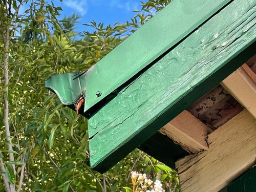

The water is sitting at the far end. I couldn’t lift the gutter off the bracket. It seems like the gutter is fixed down by the edge of the roof. I attached a photo to show it.
There’s a hole at the far end where water is pooling (but always get stuck by leaves) probably made intentionally by the previous owner or because of all the water pooling there. If I patched up the hole the water will have nowhere to run.
Does it look like I need to remove the roof edge before I could remove the gutter?
Many thanks.

You'll need to disengage the gutter clip from the front lip of the gutter. You might need to bend the front lip of the gutter up and off the clip if it is a tight fit.
The two options would be to raise the end where the pooling occurs or lower the end where the downpipe is.

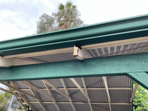

After seeing this additional image of your beam, I'd advise doing a bit more investigative work on the structure. If you're going to fix the guttering issue, it'd be worth finding out if there is any rot in your beams. I've circled some areas of concern. This could be just the paint degrading, but I suspect these are potential areas where the timber is rotting. There's no point fixing all the guttering up if it needs to come back off to fix beams.

@eeWith such a large amount of water laying in the gutter it appears that your downpipe, or gutter nozzle is blocked.  This seems to be the root cause of all the damage to the framing timber.  The rust holes in the gutter are quite likely due to corrosion where the brackets are in contact with the gutter. Firstly, someone needs to climb a ladder and clear away debris inside the gutter where the nozzle feeds into the downpipe. Once that is clear the gutter should at least partially drain.
NB: Any remaining water laying in the gutter will give you a visual indication of where the low points are and you can mark them on the adjacent timber for later reference.
If the gutter still refuses to drain after debris is removed, try clearing the downpipe by flushing it with a garden hose poked down the pipe for a short distance. If you remove the snap fitting from the end of the hose you may be able work it down the inside of the pipe in case of a stubborn blockage.
Please try my suggestions first and let us know what happens. Once drainage has been restored you can take things further.
