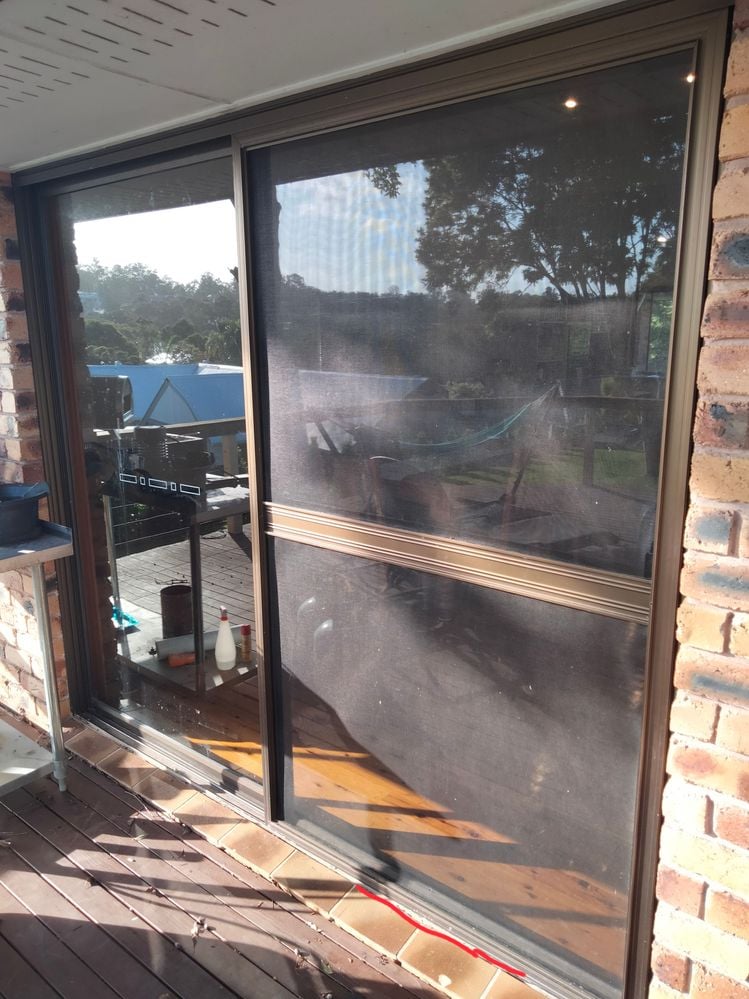

Outside patio door sill (Threshold) has tiles and mortar is cracked. Water seeps down into storage room downstairs. How do I get this sill water sealed, so no water seep into storage room downstairs?
Picture below shows sill tiled and RED line mark up for mortar cracked/degraded.
Appreciate any tips, advice.

I'd suggest breaking out and removing the cracked mortar and replacing it with a flexible sealant such as Mortafil. I'd suggest heading in store to compare the colours and select the one which will match best.
You can push Moroday 15mm x 5m White Gap Filler Rod into the gap and apply the Mortafil over the top ensuring you get a continuous bead across the whole length of the gap.
Check out How To Silicone a Gap for some guidance. The application is slightly different, but the principles remain the same.
Jacob, mate really appreciate the reply and tips. I'll give that a go definately.
