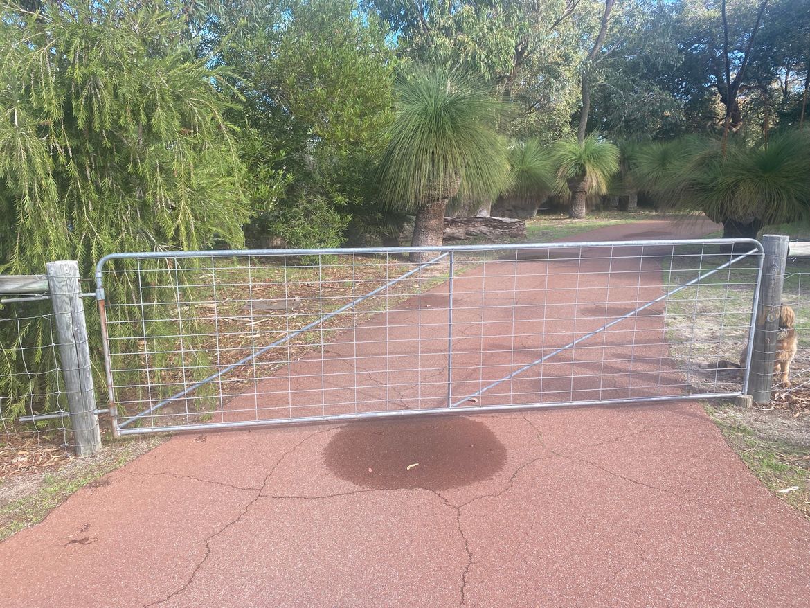

Hi, I am reinstalling our 4.4m rural gate on powder-coated steel posts so I can automate the gate with an AutomatonGate.jpg swing arm mechanism. Although the gate itself is not very heavy (~38kg) it spans over 4.4m so I want to make sure I use the right amount and sort of concrete mix. What sort of ratio should I mix please, and how many bags would I need given the posts are 2m tall and 10cmx10cm, of which about 900mm will be underground? I plan to screw some cross pieces to the bottom half of the posts to help reduce movement within the concrete, and I imagine I will need to dig holes 200-300mm diameter x 1m deep. Many thanks for your assistance
