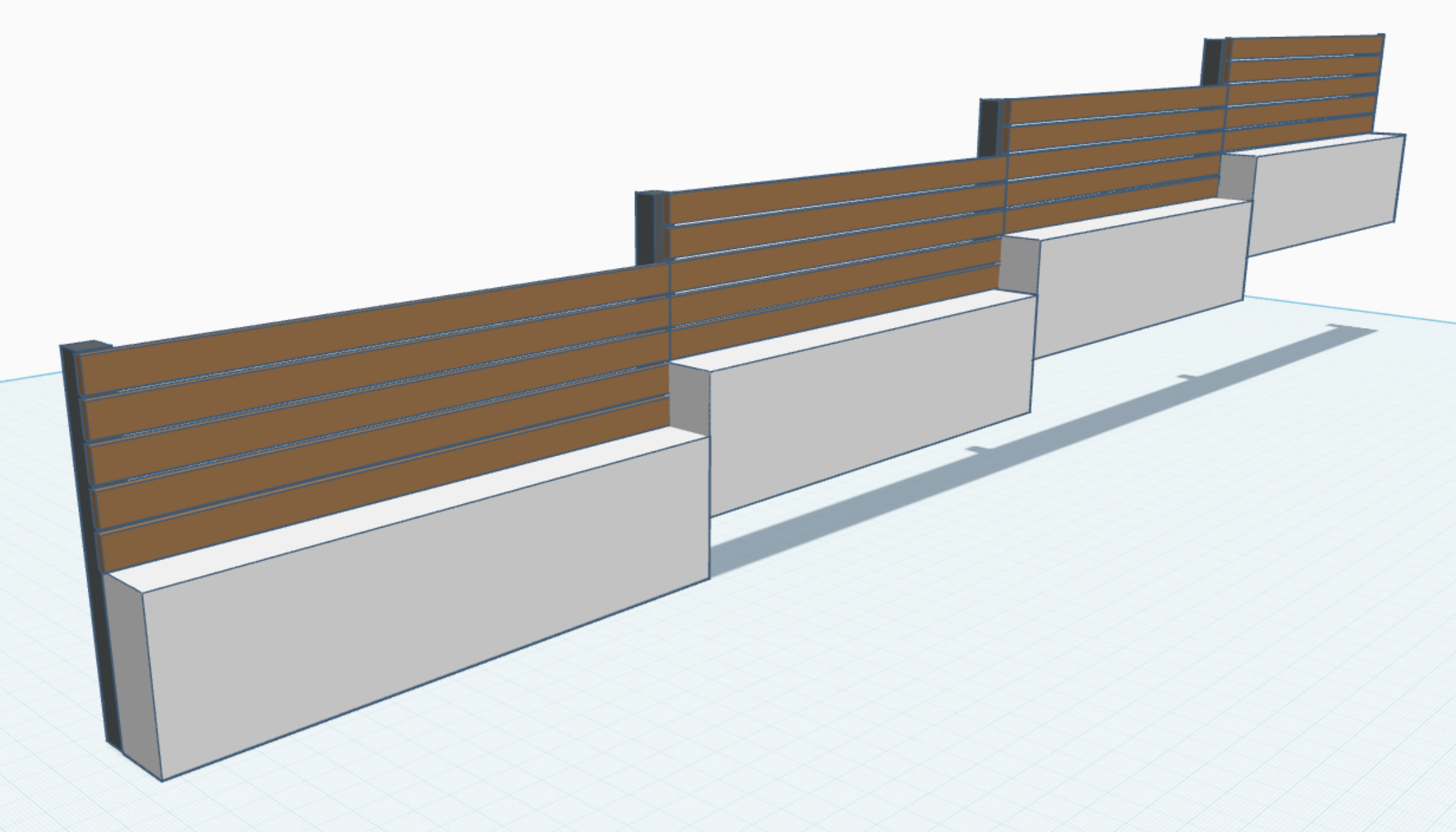

Thanks for your reply! I'm open to any ideas! We wanted to do something similar to the photo below, but with posts (Metal ideally) added on top of the existing fence Fence Idea.png

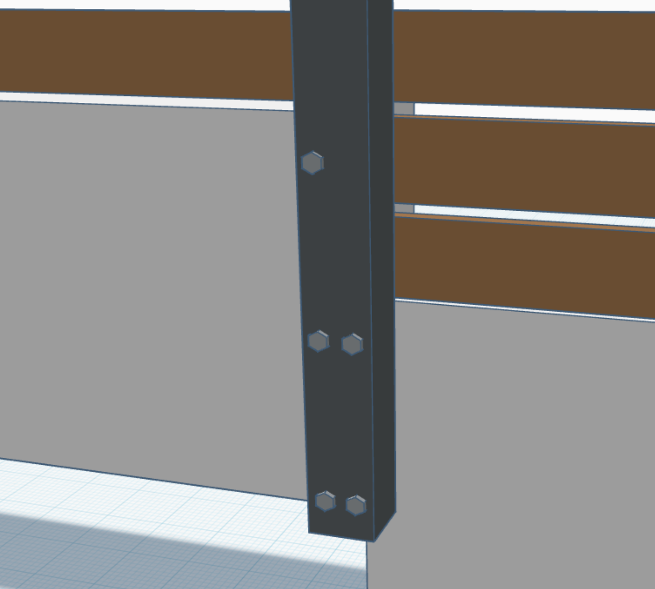

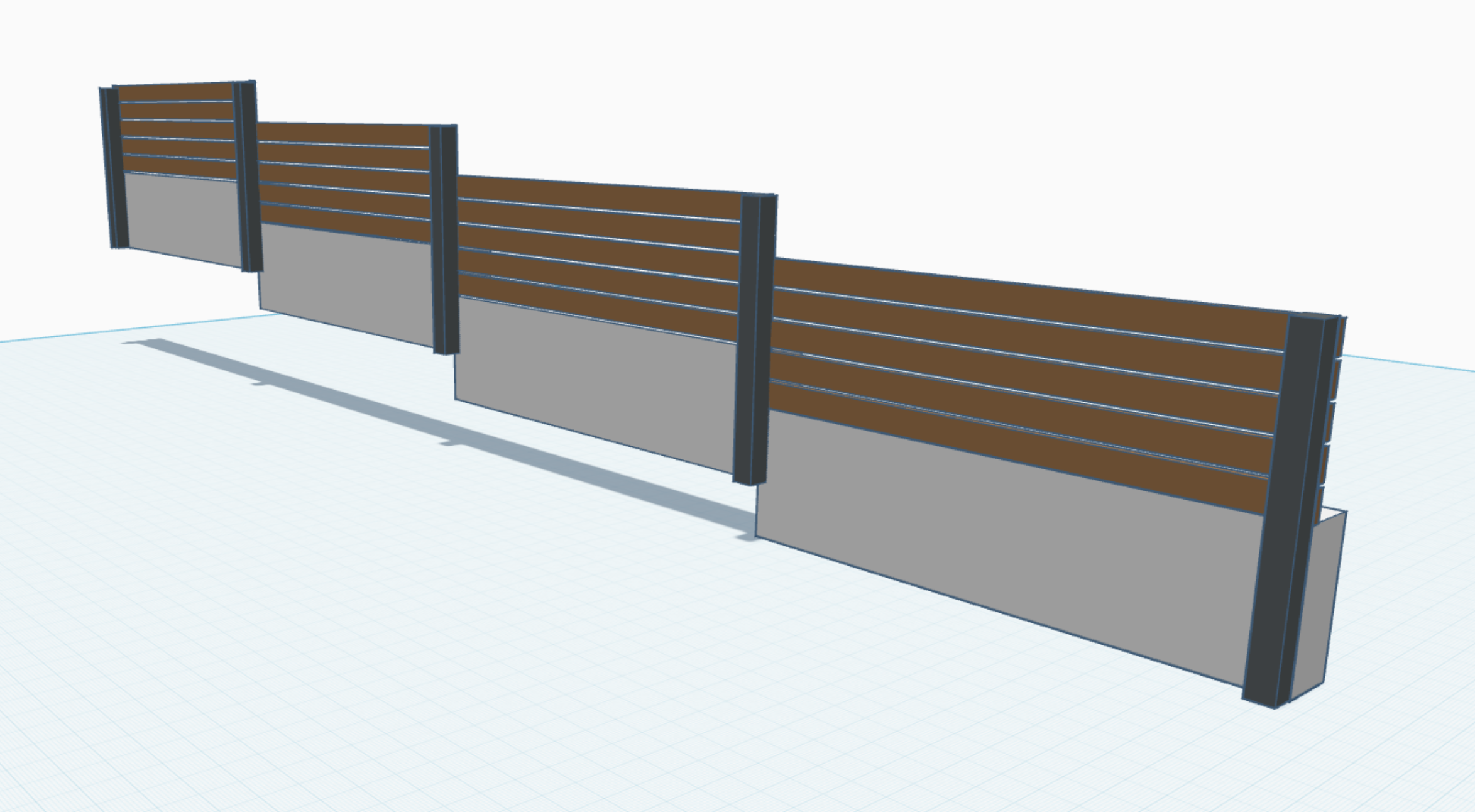

It's going to be quite difficult to mount a post directly on top of the wall. I suppose it could be done with a post support. Ideally, bolting metal square posts to the rear wall will give you the most positive connection. I've created some renderings to illustrate.
