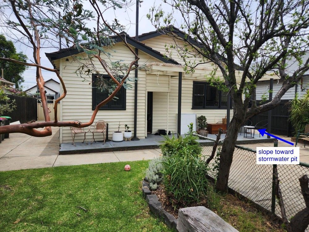

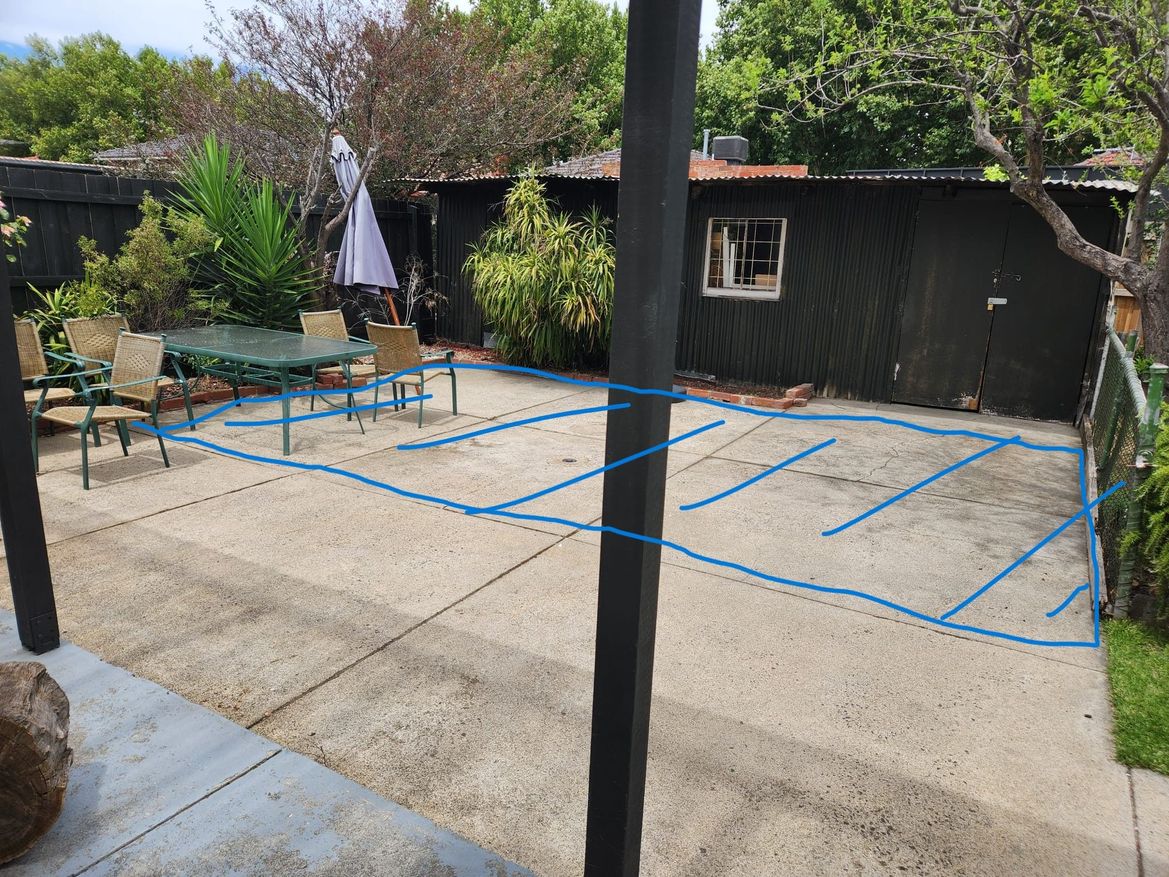

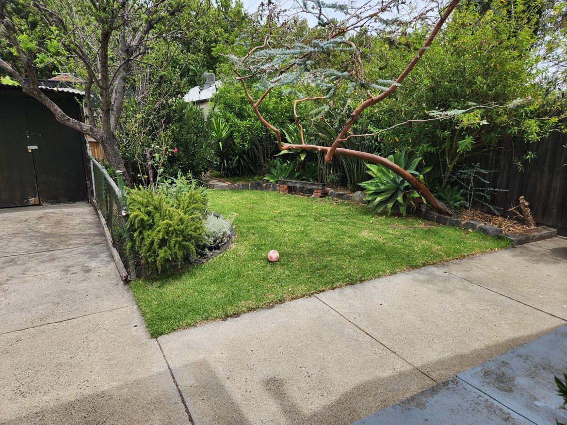

Hi, i am wanting to remove some of the old concrete that covers half my backyard to make the lawn area bigger, but im concerned about the risk of rain water soaking into the soil and causing more issues. I also dont know how i would put subsurface drainage in because i have no way of connecting the drainage to any stormwater connection?

Since the existing lawn area is growing well without drainage, the new lawn will likely be fine as well. However, given the highly reactive P2 clay, you’ll need to improve the soil to prevent compaction and drainage issues.
Start by removing about 200mm of the underlying clay soil and applying gypsum to help break it up. This will improve water penetration and reduce the risk of the area becoming waterlogged. Then, replace the removed clay with a high-quality topsoil blend suitable for lawns, which you can order in bulk from our Special Orders team.
Since your existing concrete has moved over time, leading to pooling near the shed, it might be worth slightly regrading the area to ensure water runs off naturally rather than collecting in low spots. You could also consider incorporating a gentle slope away from structures or installing a shallow surface swale if you notice water pooling after the change.
If you're still concerned about drainage but don’t want to cut into the newer concrete, you could use a gravel trench along the edge of the new lawn to help manage excess water. This would act as a basic soakaway without the need to connect to stormwater.
