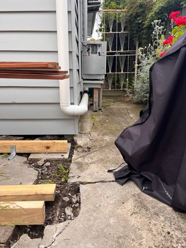

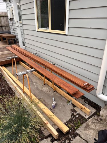

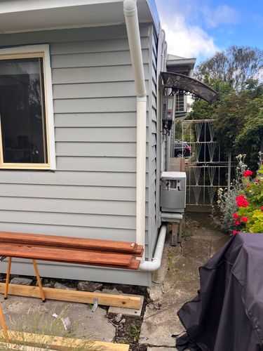

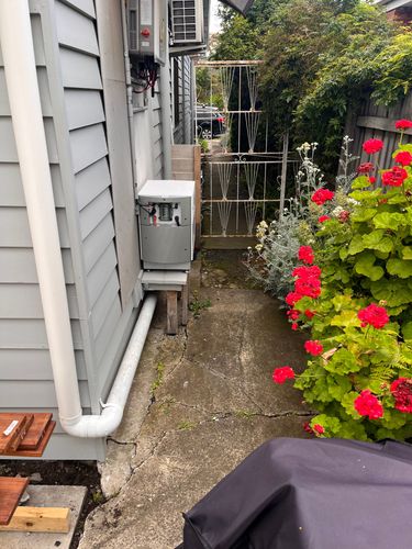

I've included some photos here. I'll be putting the house battery on concrete plinth and build the gravel path around it. The deck I'm building under the window has concrete under it, which I will remove now and ensure there's a soil fall away from the house under the decking, as well as tilt the decking so water runs off it too.
I'll look to put a treated timber edging under the weatherboard along the path to hold the base/gravel path in place. The fall would be left to right away from that side of the house.
Would I build the French drain on the fence side of the path? Does the drainage through a French drain need to go into a proper plumbed storm water drain off the property, or can it just sink into the ground after it sits in the drain?

I believe @JacobZ was referring to have the agi-pipe on the house side not the fence side. The French drain must be properly plumbed into the storm water drain. Please note that you will need the services of a plumber to connect the agi-pipe to your storm water drain.
