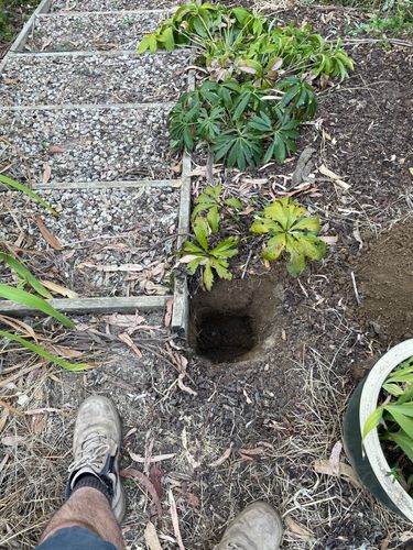

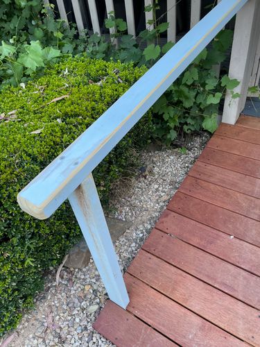

Update - holes aren’t too hard to dig. I’m going with three of these suckers then copying this hand rail made of 90mmx40mm.  3 posts across 5m may not be enough, but that’s about all I can dig.
