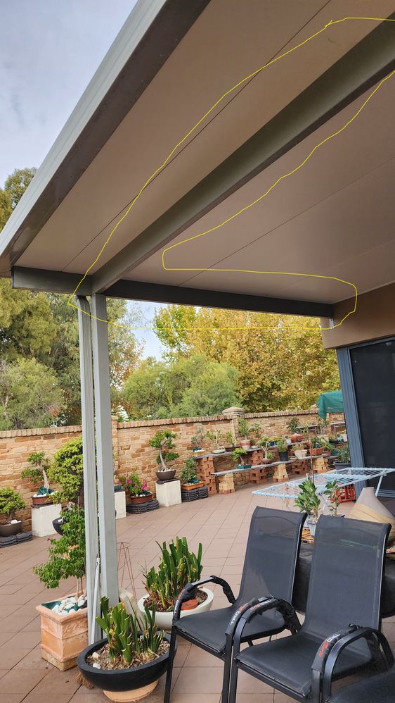

Can i install a kids swing to the beam in my outdoor alfresco? If so what attachments could i use to attach them to the beam? Beam is not wood.

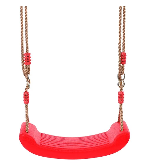

swing in question
can i install in the highlighted area

I like you thinking I must admit but I would recomend against it sadly 😕

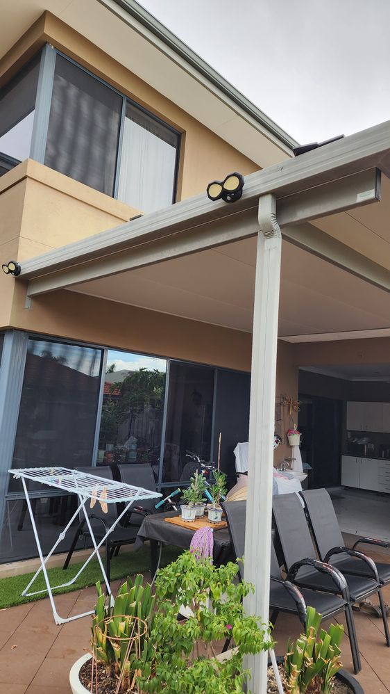

There are a LOT of forces involved when pushing even a small child on a swing seat. I dont see any bracing to strengthen the frame of your awning (from the lateral forces of the swing swinging) allso I dont know the weight rating of the roof mstructure? (Could you walk on top of it would tell you instantly if its not built to carry a load)
Welcome to the Bunnings Workshop community @cafelah. It's brilliant to have you join us, and many thanks for your question about hanging a swing.
Unfortunately, as @Dave-1 has mentioned, the beam is designed to hold up the roof, and the manufacturer wouldn't have considered the additional weight and force that a swing adds. If you were to contact the manufacturer, they would undoubtedly say that adding the swing to the beam is not an option.
Space might be limited, but I recommend you consider a standalone frame such as the Plum 3 In 1 Wooden Growing Swing Set.

Kids do fall of swings - the area above looks very unforgiving. 🤕
