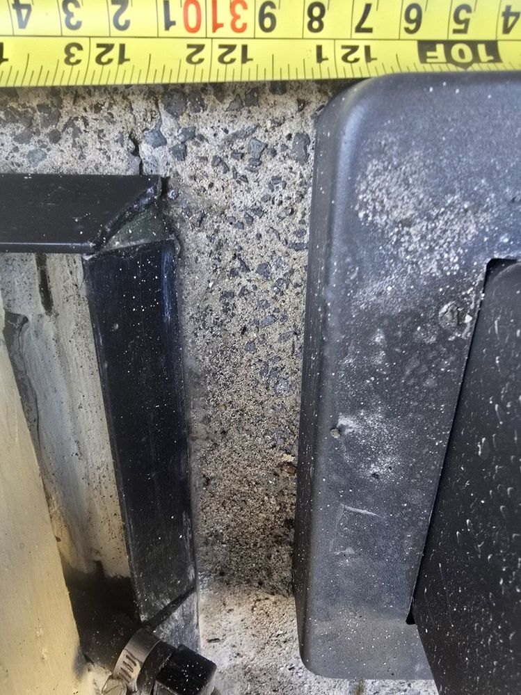

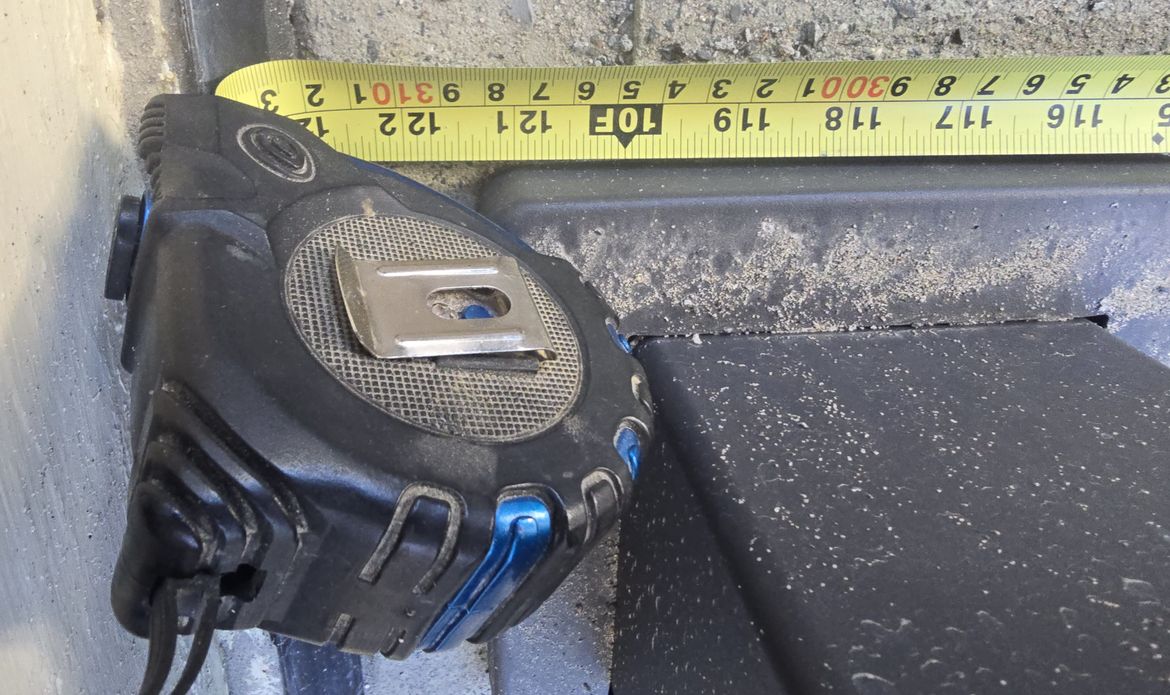

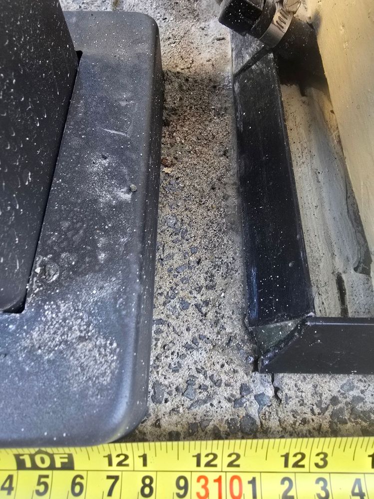

Hey Warwick,   No probs at all.  I have done some measurements/pictures.  While the pergola itself is 3 x 3, it is the cap over the feet that is slightly larger (see photos-sorry I gave up trying to rotate them)   The feet sit inside the cap, and it is a pretty snug fit.  You may be able to trim the feet and modify the cap, but you might run into warranty issues.  My unit was done in two stages.  With help from neighbours, stage 1 was assembling the frame (four posts and connecting beams) temporarily tied with rope to supporting bits.  Stage 2 (anchoring, roof etc) was done by two builder mates.  If you decide to go ahead with it, feel free to give me a hoy if you run into any probs.  The kit instructions, while not perfect, are pretty good.  It was a fairly seamless task.  cheers.  pete

Hi @Warrenp4825,
I've spoken with the team at a couple of stores that have them on display, and they have confirmed that when installed plumb, the posts are 3000mm from outside to outside, but the distance from the outside of the attachment plates at the bottom of the posts is closer to 3100mm from outside to outside.
There can also be some slight variation if the posts are not installed perfectly plumb, but the team members who checked the displays informed me that they were pretty spot on.
This means you could physically fit it in the space, but it would be right on the limit, and you would have to put bolts in far too close to the edge of the slab, so you would likely blow out the edge of the slab.
Unfortunately, you might have to look at an alternative solution.
Is there any way you could add a small extension to the concrete slab? Or is it tight up against a fence line?
