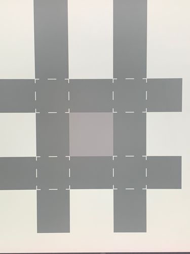

I need to install 2 45x240 for the beam with 60cm gap as they will be sitting on 150mm posts like on this image

I've given the Bunnings website a thorough search, but I could not find any other version of the Roof Extenda Bracket. Can I please ask for more information regarding how these timber pieces will be joined together? If the center piece is 150x150 will this be attached to the Extenda Bracket? It appears that the timber pieces are crossing over each other does that mean you'll be doing a lap joint on the crossing timber pieces or will they be on top of one another. If you can provide a 3D render of the assembly that would be very much appreciated.
Hi Eric,
yes on the picture is 2 45mm beams lap joined with 2 other 45mm beams. And the cross joint is sitting on the 150x150 post with cut out 45mm sides. Does it make sense?

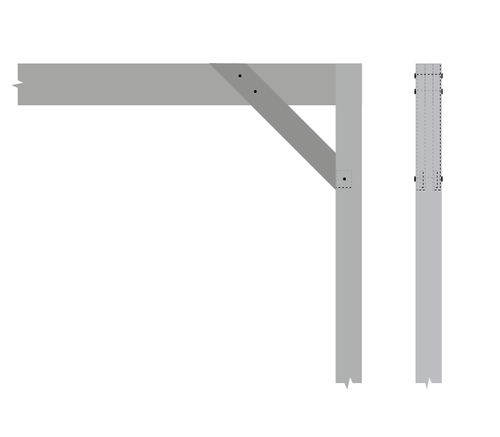

the main reason for double beam with space in between is not only to sit it on the post but also to install knee braces in between
