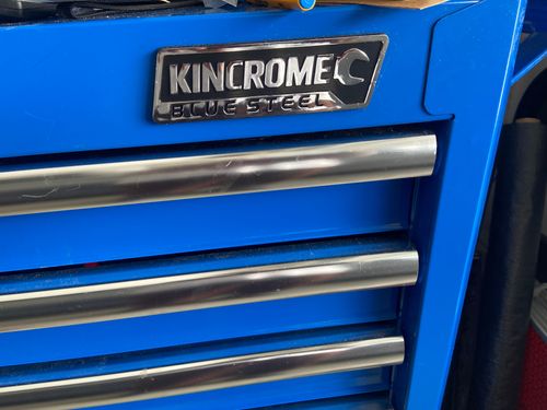

Can you please recommend any vice /
chucks that fit in to the mobile work bench for drilling purpose. At the moment, I have to enlarge the hold of the washer and not have any clamp to hold it for drilling.
I too have a Kincrome blue steel tool trolley. Not sure of having a vice there.

A small bench vice would likely be the best choice to hold a washer for enlarging its hole. Were there not any more suitably sized washers to select from? There are no chucks that I am aware of to suit that mobile workbench that would assist in holding a washer. For drilling into the post, I think you'll find a second clamp useful to stop it from twisting.

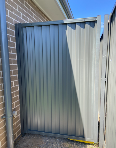

By the way, I have fixed the post to the brick wall and the gate to the post as shown hereunder. Many thanks to @MitchellMc @EricL @Neo19 @TedBear @Noyade for your guidance.

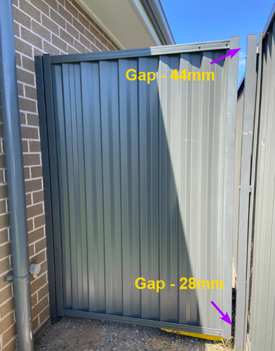

After fixing the gate, noticed that a gap is different on top and bottom of the gate as shown below.
Looking at it closely, it is too obvious. Can be gap be closed by placed 15mm spacer on top ?. If it is, then once the spacer is placed, will it look nice on top.

Re: Side Door
A grunt is a guttural sound someone emits from their mouth while straining to do something @nagumuthu.  My wife says I grunt whenever doing physical labour.
Great work on installing the post and gate!
I'd recommend attaching a length of 90mm decking to the front of the fence post. That will cover the gap nicely.

19mm thickness timber, as proposed, should it be affixed for the top half ? How about painting of the timber to match the color of the gate ?
Re: Side Door
I'd recommend fixing it over the entire length to conceal every @nagumuthu. If you only affix it to the top, it will look like you are trying to hide the gap.
You can certainly paint the timber to match your fencing. If you are planning on painting the timber, you could use 92 x 18mm 5.4m H3 Treated Pine FJ DAR Primed LOSP instead of the Merbau decking.
