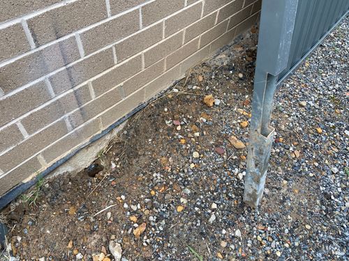

I’am having problem in levelling the posts.
Post near the brick is higher than the post at fence side and to get balanced level the post at brick side is to be pushed in to the ground.
Post and the square hole
is pictured in below image.
I recoon some mud/ concrete is inside the hole and to be removed. The hole is around 50CM deep. Which tool can be used for digging and removing the dirt from The square hole of size around 60mmx60mm.
Or the post is to be trimmed at the bottom. Which tool can be used for trimming the post.
Thanks
MM

The post is an old post and the chances are the mud occupying some space inside the hole.
