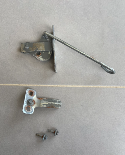

I have to paint below latch parts (for securing the gate), as the paint is peeled off. Should spray paint suitable for the purpose and does this metal need a primer. Are there any threads on how to paint below item; Should I mask anything with tape etc.

For timber, you'd typically paint with a brush, but if you need to purchase spray paint for the latch, then you could spray paint the timber as well.
Unless we know what the Colorbond colour is, it's hard to tell through pictures on a computer. Take a look at the colours I've posted below. Your colour appears to be a bit of a blue-grey, so I suspect it might be Ironstone or potentially even Deep Ocean.
I'd recommend scuffing the surface up and removing any loose paint with 120-grit sandpaper. You can then spray the latch with a product and colour similar to Dulux 300g Metalshield Multipurpose Spray Paint Ironstone. No areas need to be taped up, just do several light coats allowing the paint to dry in between them.

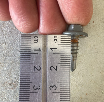

I lost few screws of below type (not sure of their name). The screw head use Socket #8 at a length of 20mm. May I know how to name these screws for shopping at Bunnings.

Those are self-tapping screws and similar to these Buildex Roof Zip C4 HexHead Screws M6 x 25 Basalt Pbx100 @nagumuthu

Does Bunnings sell below latch item. It looks bend and wondering on getting a new one.
Re: Side Door
As far as I'm aware, that type of latch should have a dogleg bend to it @nagumuthu. You can see with this similar latch Protector Aluminium D-Latch and Striker Pack that it has a bend too. I can't tell, but yours might be bent more than usual.
Re: Side Door
Thanks @MitchellMc. Probably due to wind speed, the door is moving within the latch and cause the bend due to long term impact (2 years of movement).
Thanks for sharing the link for the latch.
