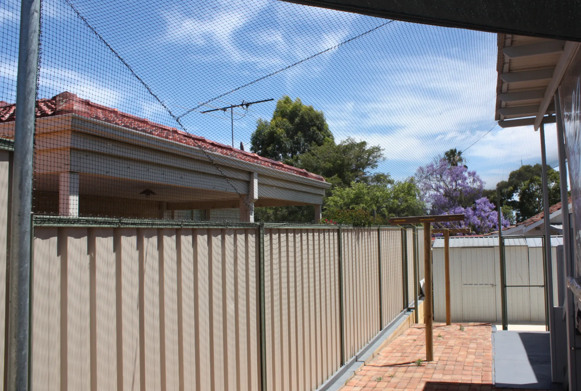

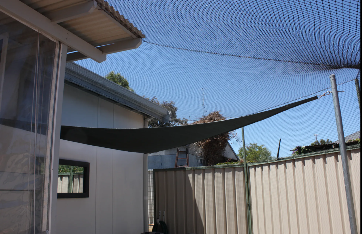

I am building a cat enclosure for my client and she want a 10x 10 m enclosure. The structure will be a net from her fence to the facia board of her house. I am having challenges on how to secure the cat netting on the fence as well as on the facia board. Also how is the net joint to each other in case i want to join? I found these photos online and is what i need.

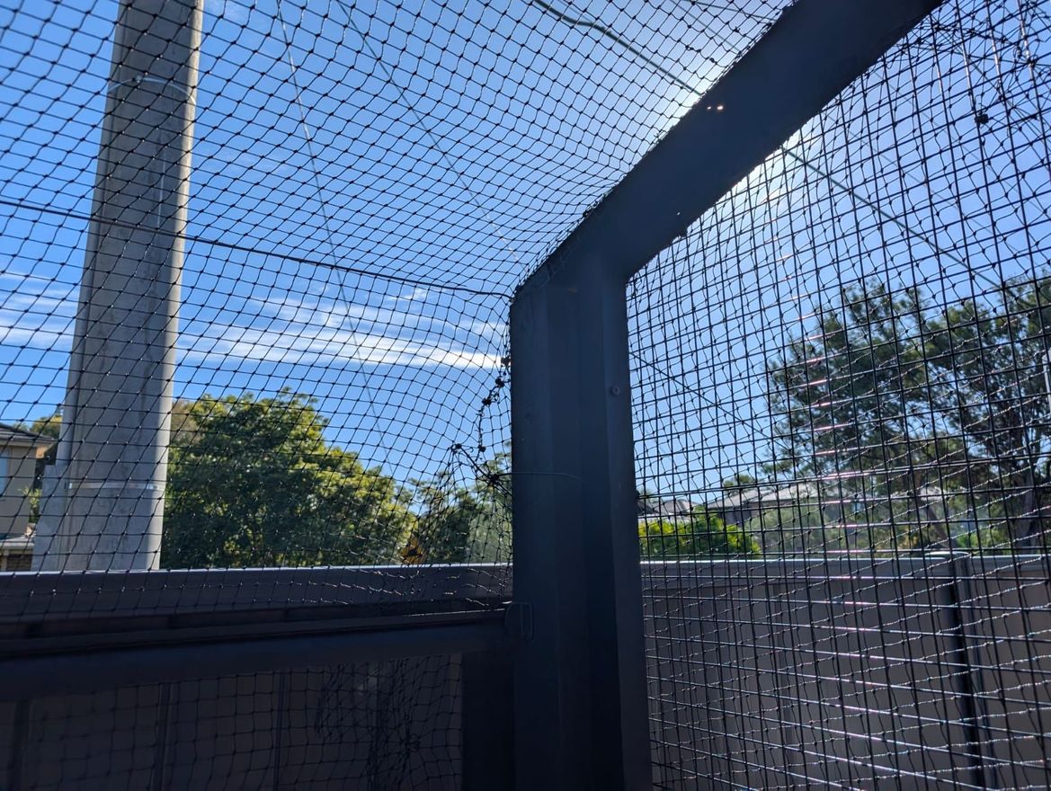

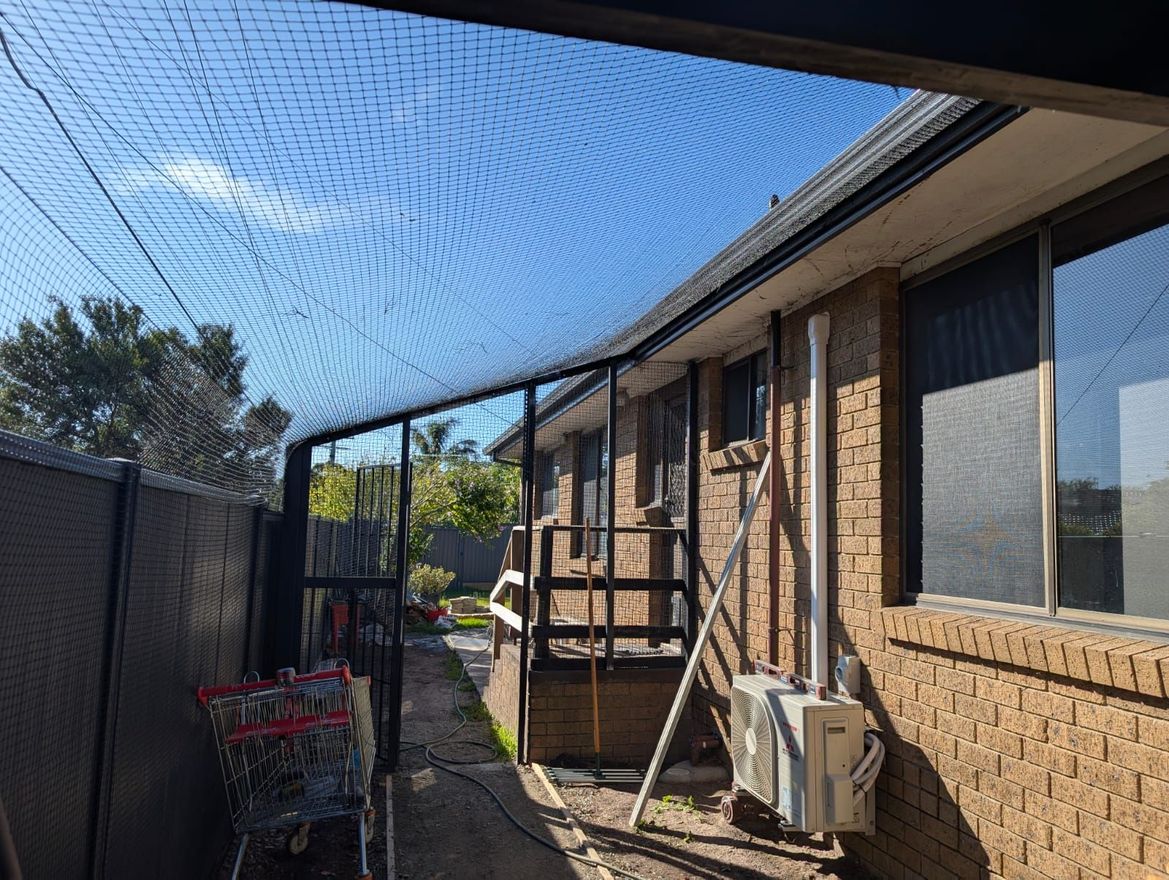

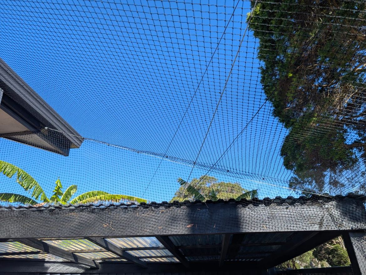

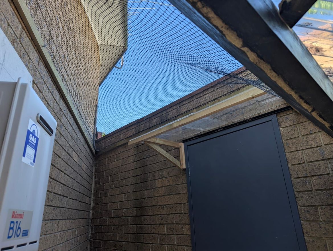

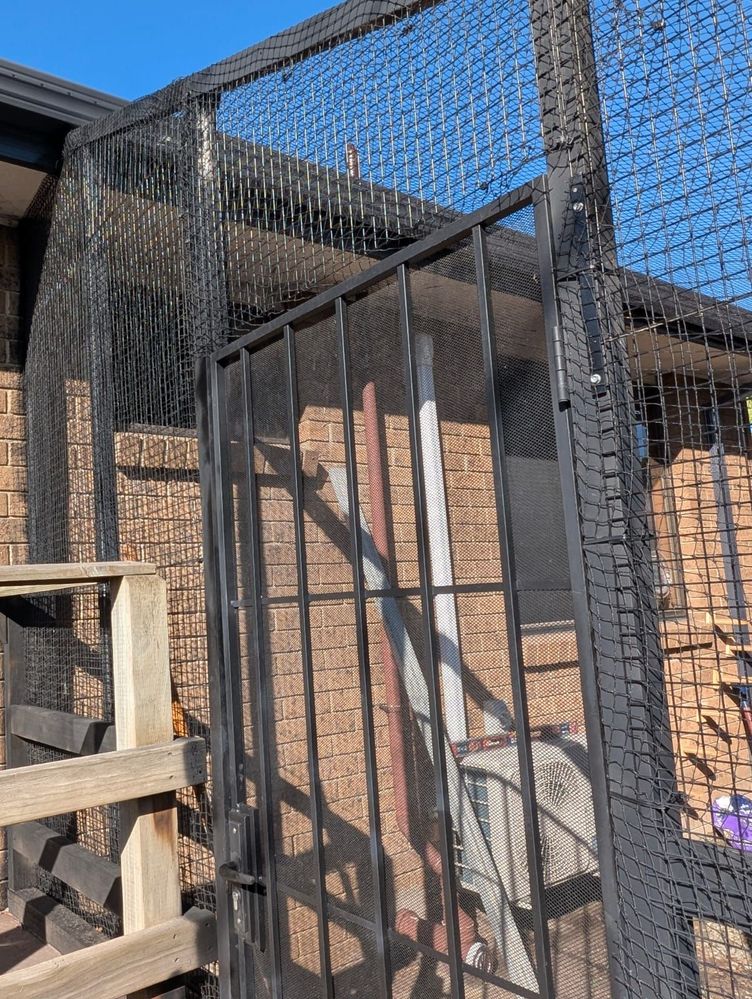

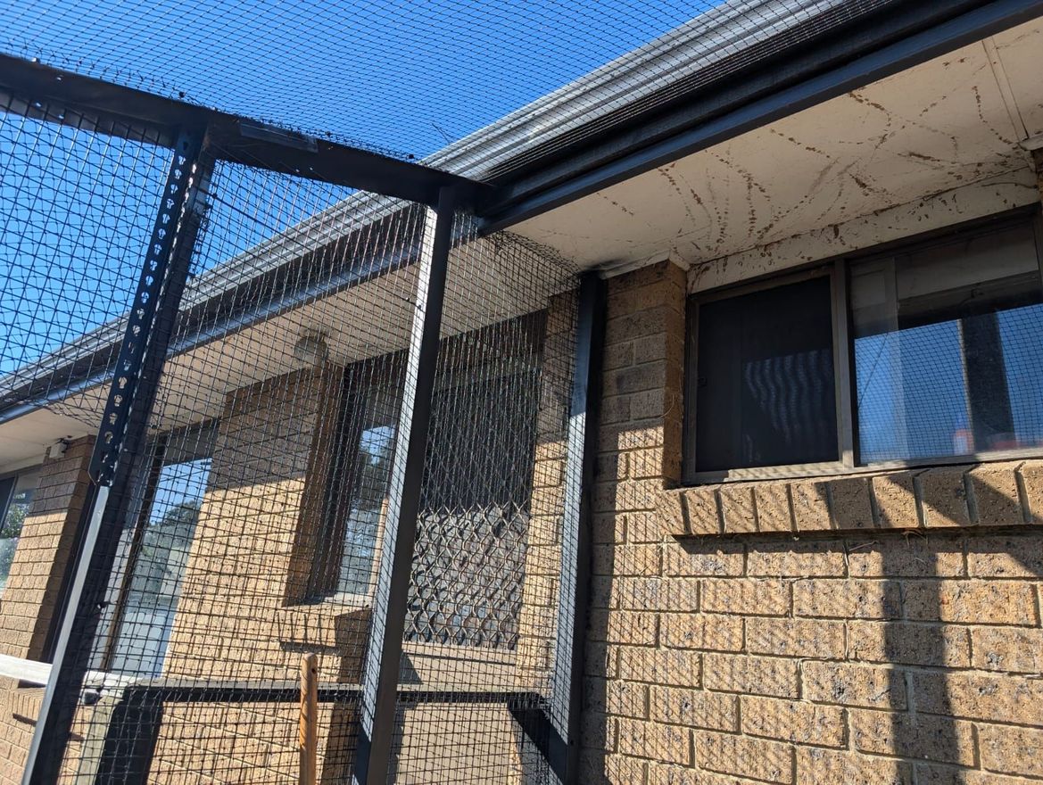

@Nailbag @Dave-1 Good Day, I am circling back with results of my recent cat enclosure build which turned out better than i expected thanks to your expert guidance and advise. I cannot give this community a big enough wrap of how much I have leaned and the projects completed by simply reseaching on this platform. Thanks to bunnings for creating the space to share and to all the gun trades who take their time to read and provide valuable input. Cheers to many more projects ahead.
Front entrance to enclosure
Net seam joining
Back garage door
Front steel framing
Corner
Steel mesh door

Good Morning @Benk
Now that looks great! Solid and clean, No chance of a great escape instance at all
What do they think of it tho?
Re: How to build a cat enclosure?
The client loved it and now her cats are free to roam in safety.

Well done on a really neat job @Benk You have done an impressive job of keeping the netting stretched perfectly across the entire area.
I reckon you should post that as a project to share with the community as there will be plenty of others wanting to learn from your experience and design technique.
