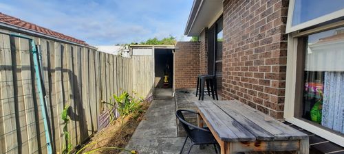

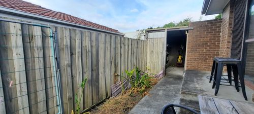

I am trying to find a cheap way to secure a section of courtyard to allow my cat to the safety and freedom to go outside when she wants too.
My issues are:
I live in a rental with brick walls that cannot be drilled in to.
There's no grass, just concrete and a garden bed.
The neighbouring fence is unstable so cannot use it to secure or anchor
There is another cat that likes to visit & isn't friendly and want him to be able to get out of his own.

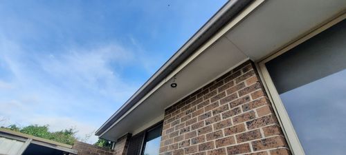

The other option is to use bird netting, though you'll need to find locations where you can fix it. If you'd like to post a few pictures of the area, then I'm sure our members could come up with some mounting solutions. Please let me know if you need assistance uploading images.

Thank you for your response, very helpful and lots to think about. I have put up some photos. I know there's a solution out there, just got to find it

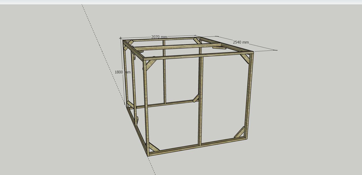

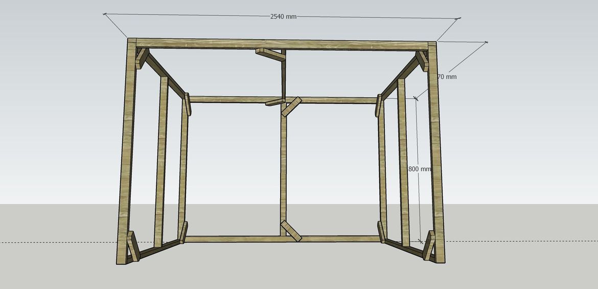

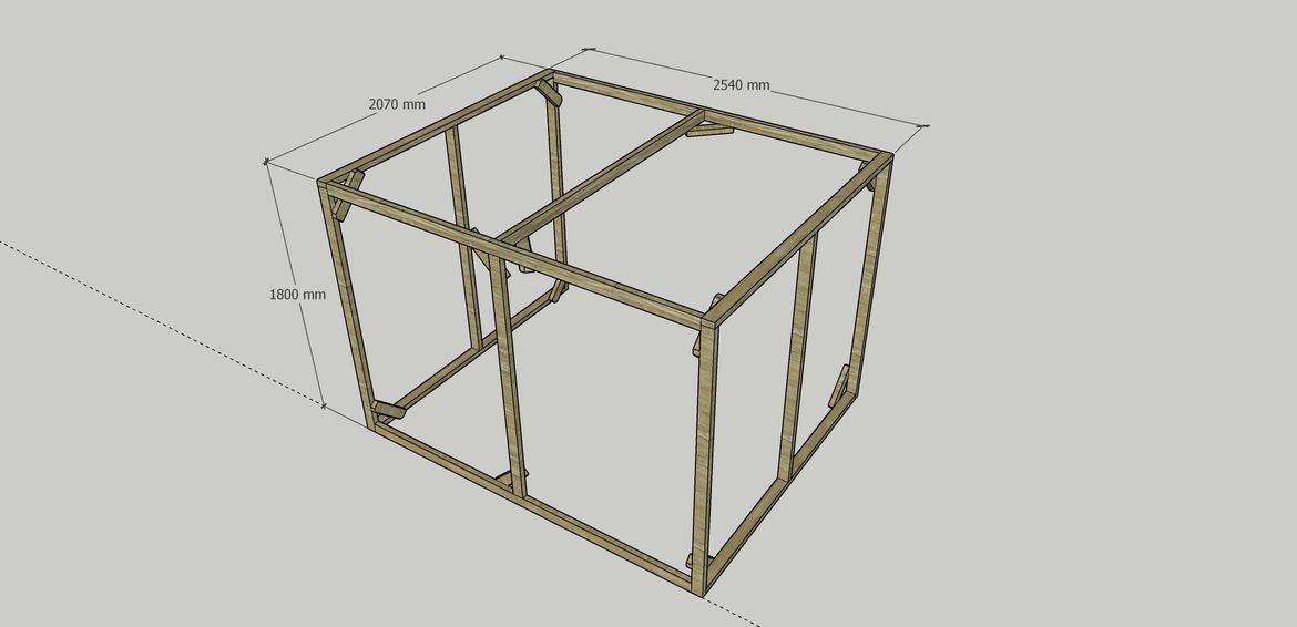

Have you considered building a temporary frame to hold the net? You can use 70x35 framing timber to build a large area for the catio. Plus if you ever decide to move, the timber can be disassembled and taken with you. It will be heavy enough that the cat won't be able to move the frame. Please have a look at the sketch below and tell me what you think.
