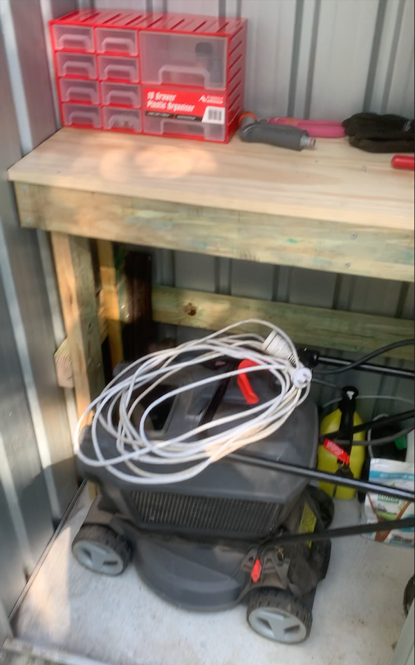

Finished the build a couple of weeks ago. I ended up not using MDF because of the price and instead used two planks of hobby wood. They seem to do the trick.
Thanks again for all your help. It really gave me the confidence to go ahead with the project.

(Not the best photo)
