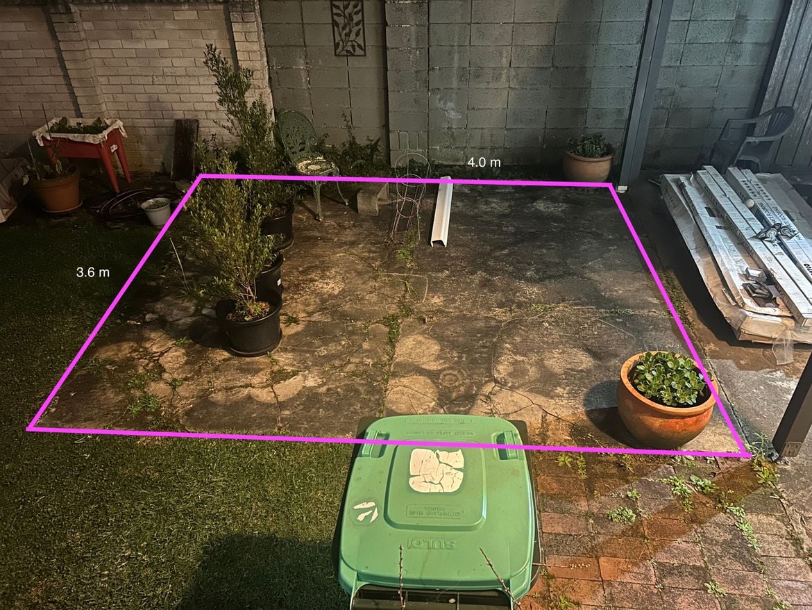

I am an absolute novice and need some help to get started on a low-level deck to cover an ugly and cracked concrete slab.
The slab is 4.0 x 3.6 and I want to keep the deck a low as posable so I won't be able to do bearers and joists. The slab is not even and is open to weather so I need a way to level the deck and allow for water to run away.
I really need a design and a materials list. Help!
I'm thinking to build a rectangular frame from timber - I don't know what type or size - and then to 'fill in' the frame with more timber - again no idea about type or size or how to attach or space the timbers.
I'd like to level the frame with plastic pedestals to improve drainage, but I don't know what size or type or how many I would need. And also if I would need to attach them to the slab and how I would do that.
This is all before I even think about the deck surface. Thinking treated pine so I can paint it.

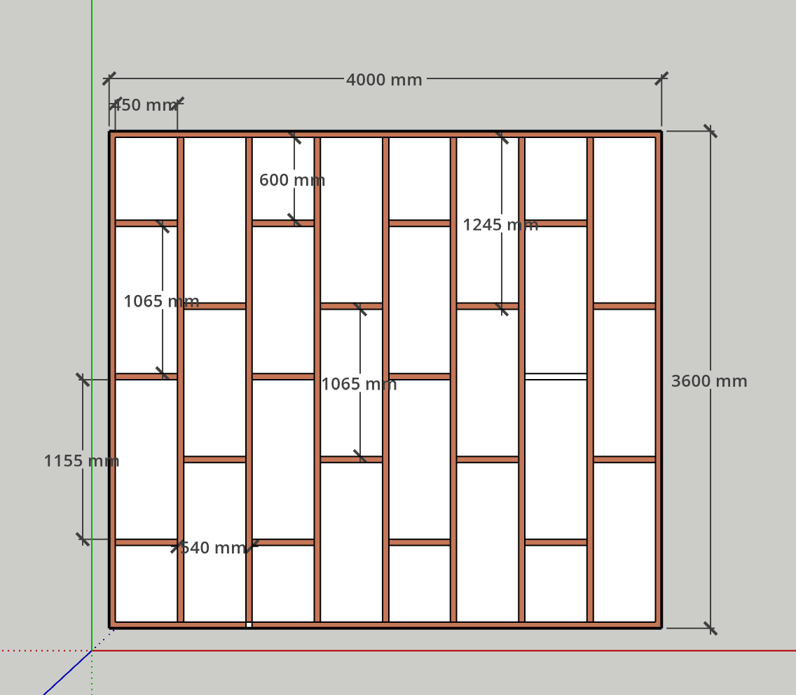

The double joist assembly is only needed if you are planning to build your deck with a picture frame around it. Yes, 450mm spacing is used for joist centres, you'll need to share your plan with us in order for us to understand how you've placed the joist in the frame work. Yes, you'll need to put noggins to stiffen the framework of the deck. In regards to the pedestal footing, again we'll need to see your framework plan so that we can confirm its position. Because it is a free standing decking frame using brackets will fix the frame in place.
My best advice is to draw the decking frame on a piece of paper so that we will have a clear idea of what you are trying to build.

I have drawn a plan and it is attached.
Could you please advise about spacing for pedestals - how many and where - and if I need to sercure them to the concrete or should be using brackets to top the deck moving. If I use brackets, how menay would I need and where would I out them given that the slab is not level.
If I wanted to put a lazy boy inflatable spa on one corner, what change would I need to make?
Re: Novice building a low level deck
Hello @su51q (Susan)
On the condition you are using 90x45 framing timber I suggest using a spacing of 800mm per footing. The angle brackets come in various sizes, so you'll need to choose the one that allows you to adjust the level of the decking frame relative to the level of the concrete base. This is on the condition that only people will be standing on this deck, and no heavy items will be placed on it such as a spa.
Please, note that the general weight of a Lay-Z-spa is around 670kg++ when filled with water, if you include 4 possible occupants you are looking at a total weight of 900kg++. Your current decking plan will not be strong enough to hold that much weight. I propose engaging the services of an engineer in order for them to calculate and create a decking frame plan for you that can hold the weight of the spa along with people in it. This will include the proper footing for the deck and the size of deck framing timber to be used. This also guarantees that the deck will be safe, built to local code and council regulations.
