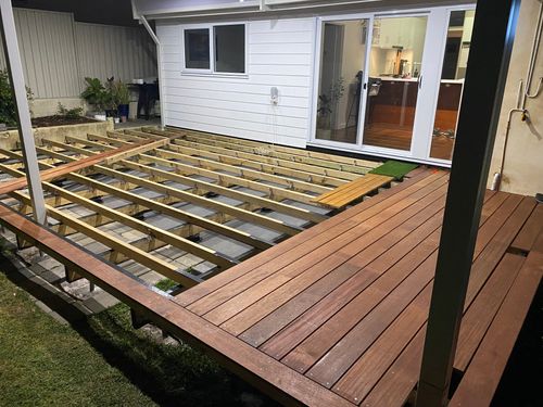

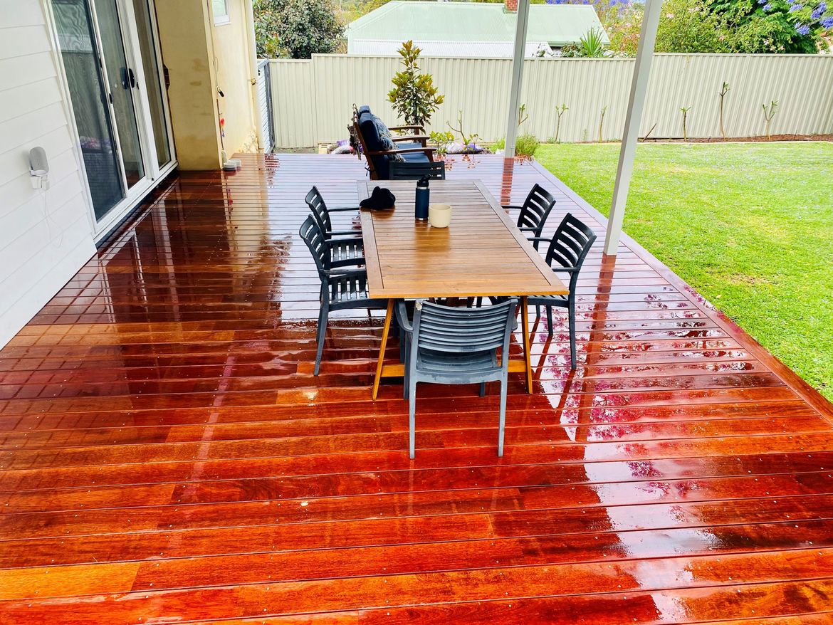

After some holds up with work, travel and holidays sharing my deck pics. Bar the final oiling and a few trim pieces very happy with the overall result. Thanks for your help and advice team 👍
Hello @PscottDIY

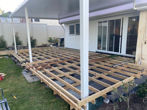

Thank you so much for posting your finished project, it looks magnificent. It looks so inviting and relaxing. Did you by any chance take pictures of the frame while you were assembling it? Did you eventually use the 90x45 timber framing? What footings did you utilize?
Again, thank you so much for sharing such a wonderful project.
Cheers Eric,
bearers were 140x45 , joists 90x45 , as the concrete underneath had quite a fall and was also smaller than the finished deck size I used a combination of footings / fixings. Galvanized angle brackets at the lowest points and then Buzon adjustable pedestals ( a great sturdy strong rated product- Bunnings should stock them
, also concrete footings with stirrups at the end of the bearers. The frame is really sturdy and I’m very happy with it 👍
