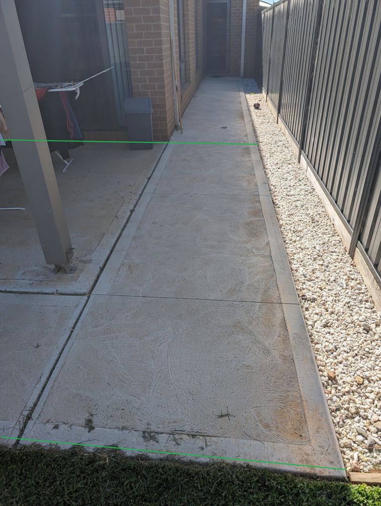

I'm trying to build a deck in our alfresco. At this point, it's still on the planning stage. I've seen a few posts here and there on this forum and would very much appreciate some further inputs to more experienced people than me.
My background: I work in the IT industry and "hardware" isn't really my thing lol. Anyway, I've built a few benches, and tables (nothing fancy) but not really built anything as big as an outdoor deck.
Project Alfresco: We have a small alfresco that my wife insists should have a deck. I agree, and I want to build it myself. Here's some bit of a challenge. The brick height is low, and also, "not even" from the side near the wall (corner of the doorway), it's around 130mm slopes down to 125mm the other side. Also, what would look good:(1) building the deck only on the slab of the alfresco, or (2) including the one outside as well?
Should I build a deck to included the ones outside the Alfresco slab?
height is 130mm from the left sloping down to 125mm to the right
Need suggestions on best way to build it, should I use this? https://www.bunnings.com.au/tuffblock-300-x-300-x-90mm-instant-foundation-system-deck-support_p24103... shour I do something else? Open to any suggestions at this point since this is my first build.
thank you.

So, in this case, @yeahboo, I'd just make the deck a perfect rectangle working off the largest width. On the smaller end, the deck will overhang the edge of the concrete 3cm, but that won't be seen underneath it.

Ok that makes sense I guess. and if in the future, I want to add a deck patch leading to that door, the logical thing is to make a straight line from the existing (assuming I finish this lol) one right?
Also, another question I have regarding the frame... I plan to use the pedestal blocks, and I am assuming the edges of the frame near the wall and doorway should be "touching" the wall right? In that case, how should I go about placing support for the frame near the wall/doorway? or is that where the anchors come in? (Which Eric said I should try and do a combination)
Thanks!
Re: How to build a low-level deck?
That would be correct, @yeahboo.
So, you'll create a frame for the deck structure and then fix the joists within it. You'll screw through the frame into the ends of the joists. The feet can then be placed under the joists instead of under the frame as they are connected. That allows you to set the feet in from the wall and the deck's perimeter.
Unless there is a need to connect the frame to the wall, I would try to avoid that, as it adds another layer of complexity. There's no issue creating a floating deck entirely supported by the pedestal feet.
