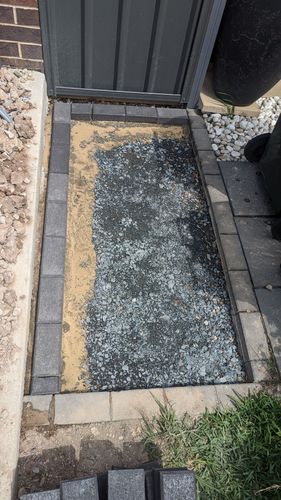

Hi All!
Just to give an update.
I poured roadbase and compacted it as best as I could with a homemade tamper :P.
Then used Sand and Cement dry bed and layed the left side border, I brought it out a bit as I don't want to chip into the concrete driveway's excess concrete. Going to fill the gap with pebbles I think.
Then also did the same for the top border.
Got a straight wooden bar and made sure both sides are levelled horizontally. Ideally I wanted a slight slope down but the right side border which was there already had a drastic slope so I just levelled it with that otherwise neighbour may have an issue with it.
Because of poor alignment on the right border, it was measuring around 76cm internal width towards the top and 78cm towards the bottom. Oh well, first D.I.Y for bins 😂.
Going to lay herringbone pattern so I just tried a sample lay before putting paver sand down.
Let me know if anything to look out for prior to laying.
Re: Paver Platform for Bins
Hi @toffeeapple
Thank you so much for that update. It's looking very good, and that herringbone pattern looks fantastic.
Please keep us updated with your progress, we look forward to seeing it complete.
Morning @toffeeapple
That looks great! It will be so nice to have a smooth area to trundle those bins!

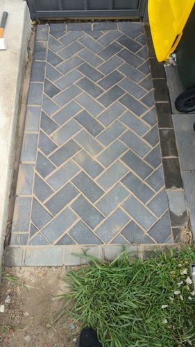

I have finally completed this project with the spare time I have here and there.
That looks amazing @toffeeapple!
Well done; I trust you are super-happy with those results.
Many thanks for sharing.
