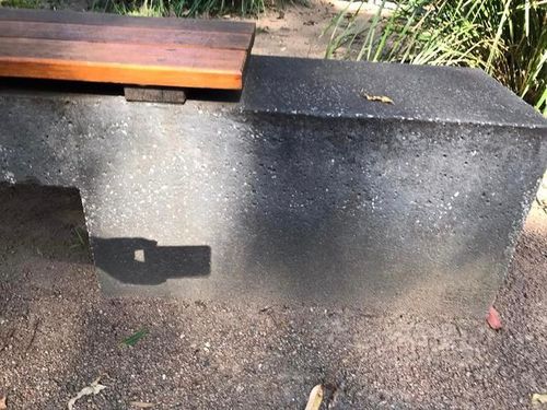

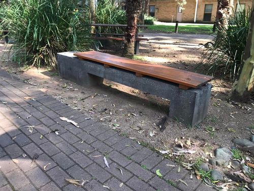

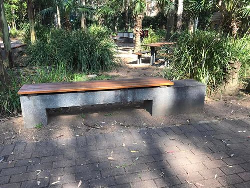

These are the "concrete" seats or bases for garden beds I was describing.
The fat end is 1/3 to a half of styrofoam in the middle. You save on the amount of concrete needed plus its lighter. (No way could you move these bty, they are heavy!) They made the seats insitu with formwork. and I saw them using styrofoam to fill the voids.
For your instance you could go the same route and have the fat end taller to enclose the garden beds?
at leats half is styrofoam on the inside.
Even the short leg had styrofoam within it.
They have been there for at least 5 years.
