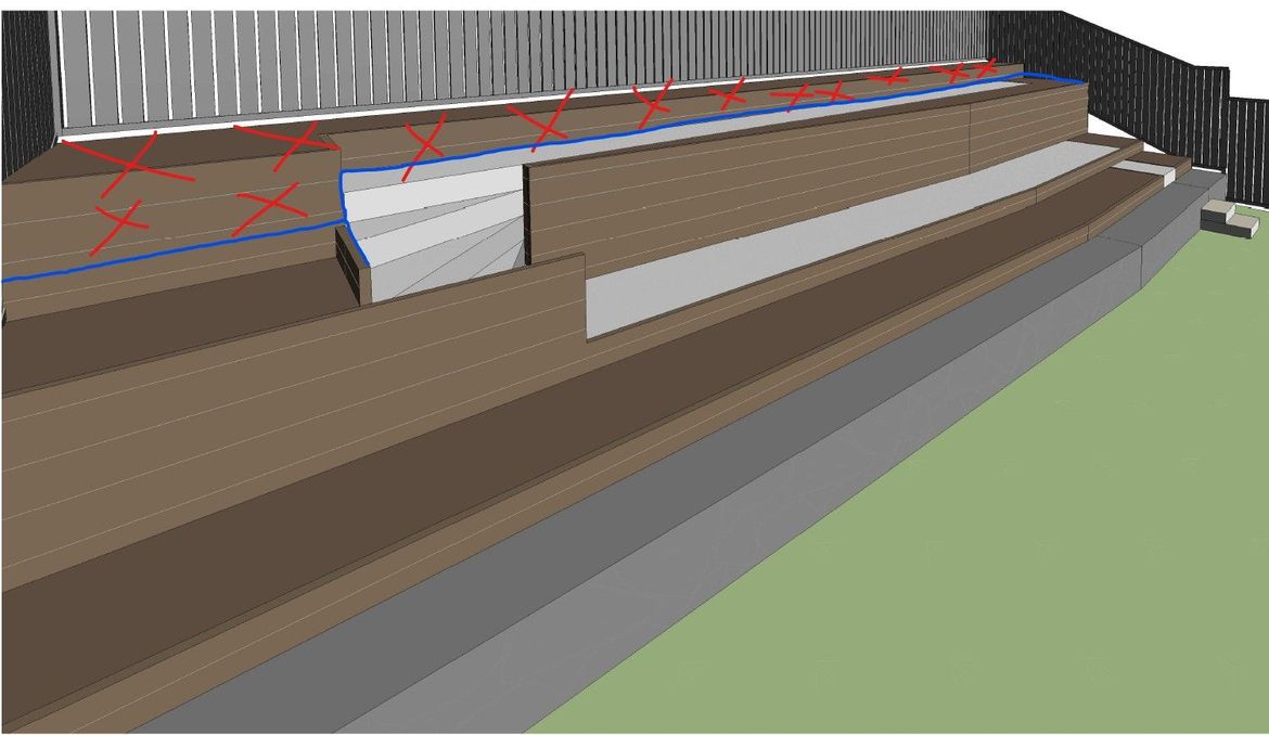

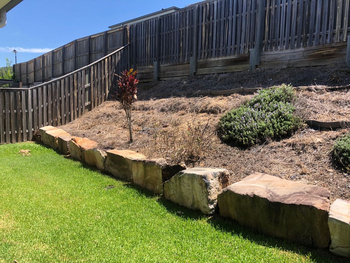

I am looking to build a food forest on my sloped back yard (attached photo). I have a landscape designer produce a concept design for me (attached photo). The garden beds will be terraced with pathways to meander through the garden.
I have had some quote from professional landscapers and the costs are quite high. Therefore I am keen on attempting to build this myself if possible, although I have no hands-on skills and would love to learn. I understand that the garden beds, regardless of where they are terraced in the slope also act as retaining walls. I want this to last as long as possible so I want to do it right.

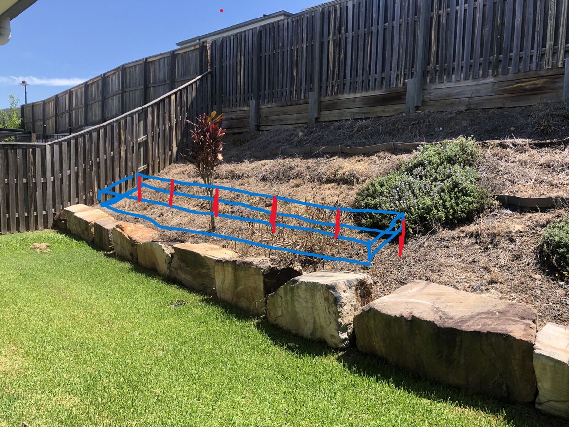

I want to build the first level using ACQ H4 Hardwood sleepers as the bed will be used for food; I am not sure about the thickness of the sleepers - whether it should be 50 or 75mm. It will be 200 - 400mm above the existing soil, when the final growing soil is added, it will be ~200 - 300mm above the existing soil. I was originally planning to stake the beds but I understand that doesn't add much strength against the soil, especially when wet. I am therefore planning to add galvanized steel posts to hold the sleepers. As the maximum height of the sleepers for the first bed is 400mm, I understand that the posts will also have to be the same distance below the soil.
I understand that drainage is also important in the longevity of garden beds and retaining wall so I originally wanted to add a socked agi pipe against the back of the sleepers. But I found that there is also an existing agipipe (socked) running behind the stone blocks. This agipipe is shared with the neighbors on both sides.
I have a few questions at this stage.
1. Will I still need to add another agi pipe when I build the first level bed? And will this be simply connected to the existing pipe?
2. When I dig down to install the posts, the posts will be roughly on top of the agipipe (as digging 400mm down will hit some of the pipes). Am I able to add the posts and cement while the agi pipe is there?

and love those sandstone blocks of yours! So lets step through the things you have mentioned and questions you have.

Thanks for your recommendation regarding the posts' location. The agipipe cannot be shifted as it runs across both Neighbour's property. As it cannot be added above the existing agipipe, I will have to move the posts back, leaving a small space of soil between the rock bed and the front of the sleepers. If I was making the first level 1 sleeper high and I created an enclose bed, could I use the rear sleeper wall (in image) as the retaining wall so that I would ensure appropriate depth and steel posts (in image, red lines) to hold back the large amount of soil from the higher end? Whilst the Front could use some stakes or rebar through the wood to hold it down? I'm a bit confused at this point - I see alot of online photos sloped yards terraced a metal posts or concrete to hold the beds down, but simply some rebar or wooden stakes hammered into the ground to hold the bed in position (see example image) - Will these builds not last very long?
Regarding your comment on the depth. Is that a universal rule for galvanized steel posts to be 600mm deep, regardless of height? I had though that the height above ground is the same as height below ground. So if I were planning a 1 sleeper high (200mm) front of garden bed, I would still need to dig 600mm for the post to be cemented?

Unlike a straight line retaining wall, if you are building boxed raised garden beds albeit tiered, I don't believe you will need any gal posts as each box has both return sleeper connections and next level to hold them in place. Basically the same as there sample photo by DIY designs.
As for answering the depth of a gal retaining post, depth in ground is based on depth out of the ground. So, 600mm above ground then it's 600mm in the ground etc.
