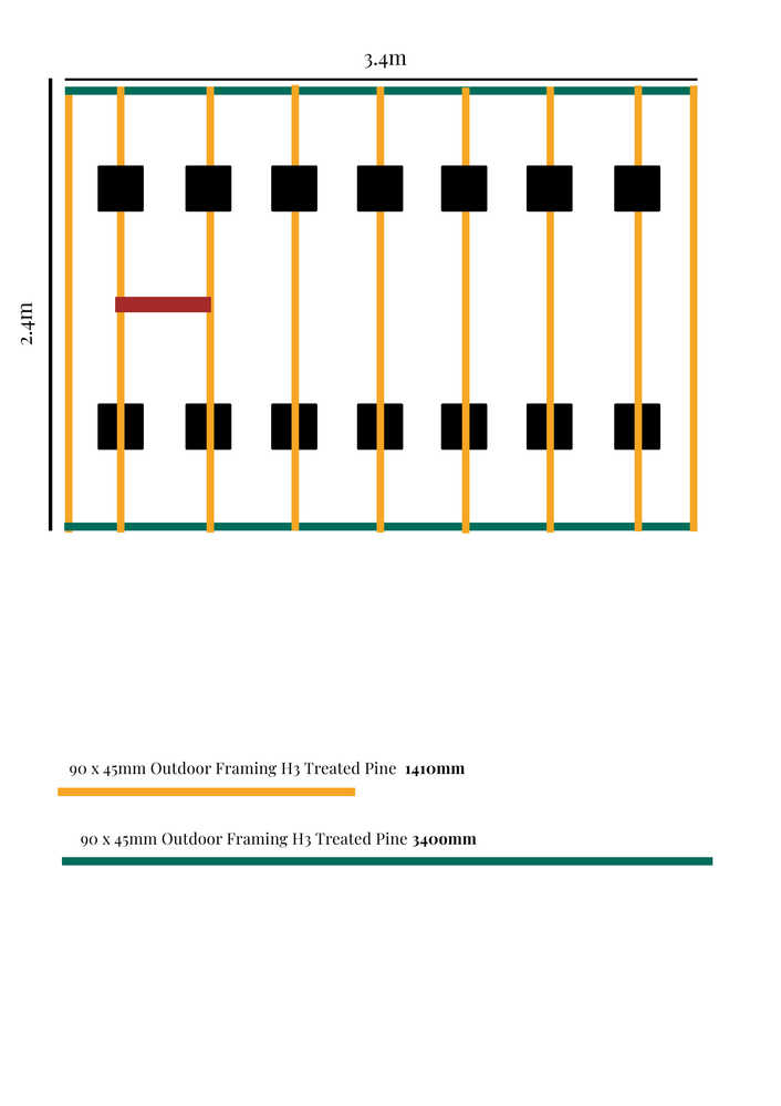

There has been an update to extend the deck to 2.4m
My questions would be:
1. Do I need another row of DECK blocks as pictured?
2. Do I need beams (green) running horizonally as well? or would the yellow beam be enough?
Thanks
Hi @Samc1234,
The yellow beams would be enough, but there is no support under the outside joists. Provided the supports are no more than 1000mm apart, you do not need additional Decko footings.

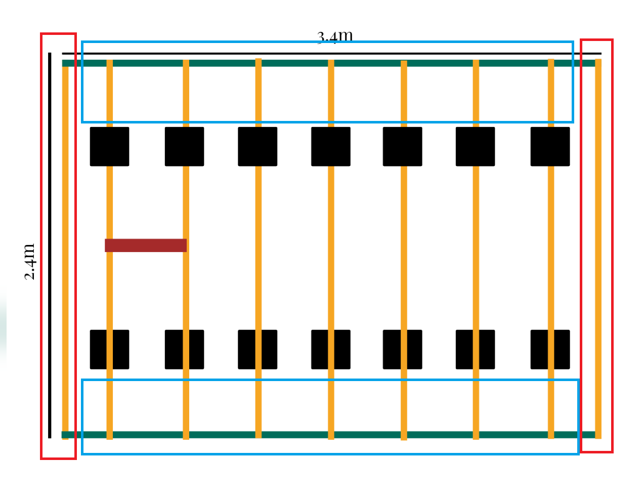

Thanks, so below is the updated version,
I have removed additional deck footings, on the DECKO guide it states that support will not be needed if they are close enough to the edge? is this correct?
In addition, do I need beam supports as seen in the red or not?
They would likely be referencing the areas I've marked in blue @Samc1234. As long as the footer is near the end of the joist, the counterlever is supported. However, the joists I've marked in red are entirely unsupported. If you could imagine standing in the middle of those joists, they would bow down under your weight, as there is nothing supporting them. They are floating in the air.
Thank you, so if I put decko footings unde the red parts everything will work?
Hi @Samc1234,
In increasing the width of the deck to 2.4m, you would no longer be able to use the two deck blocks per joist that @MitchellMc recommended. To be in line with the Joist Span Tables, you would need to space your Decko footings no more than 1400mm apart, which will leave you with a cantilever of 500mm on each side, which is simply put, too large.
I've provided an explanation of what is generally allowable in terms of cantilevers in the discussion What spans and cantilever for deck? The allowed span for 90x45 timbers is 1400mm; 25% of this is 350mm, which is less than the 500mm cantilever you would require on both ends of your joists.
You have two options in this situation. Either add in a third Decko block so you can shift the outer two blocks closer to the ends of your joists, or use larger timbers such as 140 x 35mm H3 Treated Pine, which is capable of spanning 2300mm between Decko blocks.
If you make these changes and add Decko blocks to the red joists, then yes, everything will work.
