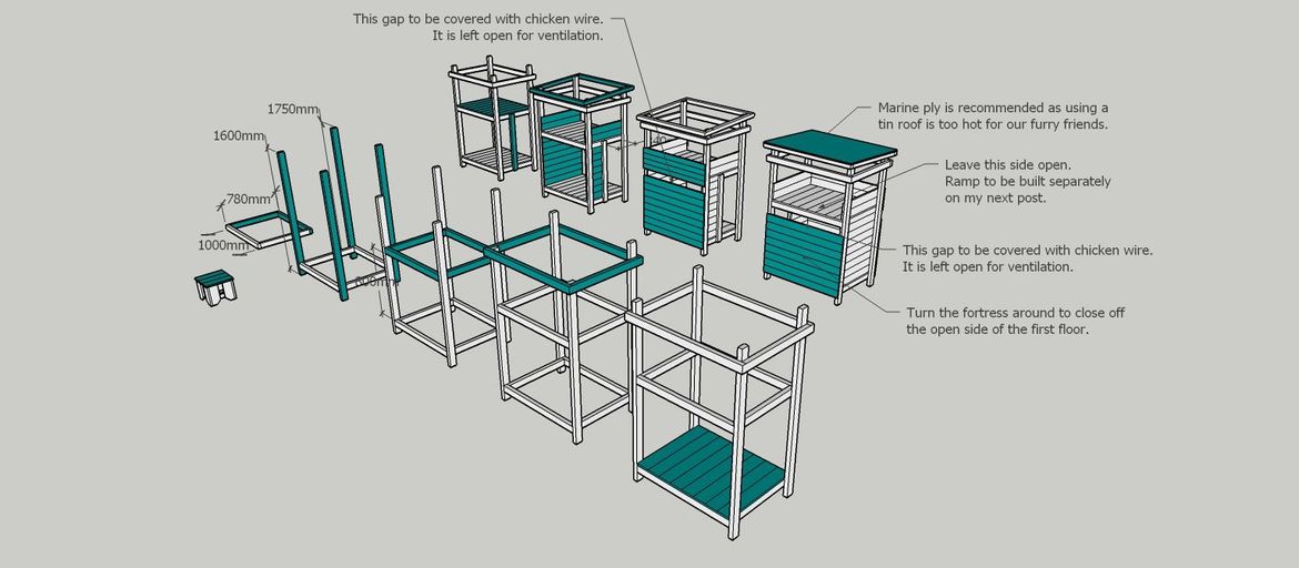

Hello @IDIM
If your up to the #buildchallenge then I suggest trying to build Furry Fortress! Sizes indicated are suggested only as you can re-size for your four legged friend! The main material used is UT MGP10 70x30 non structural pine timber comes in 3.6 meters. What you use for your floor and sides I leave to your imagination. This is a more involved build as it is composed of more steps! Want to practice first? Just type in "weekend project" on the search bar and you will see a stool/plant stand you can try out. Still feeling confident? Simply print the pictures and write down your cut list and have at it! Now you may be wondering why the second floor is open on one side? This is the look out spot for the dog and I will post the ramp build in my next post. If you have any questions please post it here on Workshop and I will try to answer as best as I can. Remember build it as you see it! Stay safe!
