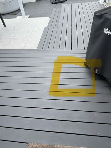

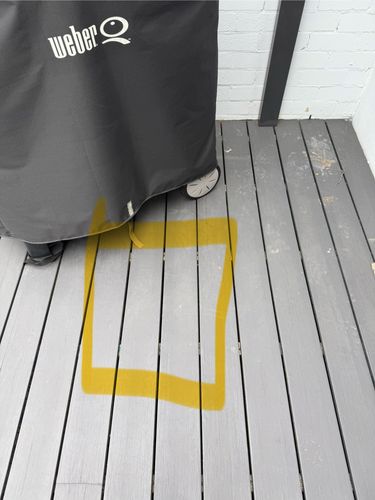

I have a fully enclosed pine deck and I need to a quick access point for sewer and stormwater lines.
Grateful for your ideas and tips on how to create a simple, low skill required, trap door within the deck? Please note that I have minimal skills and tools so a simple (not perfect) solution is required.
I propose using my jigsaw to cut a square in 4 planks and then bolt in a pine frame and hinges.

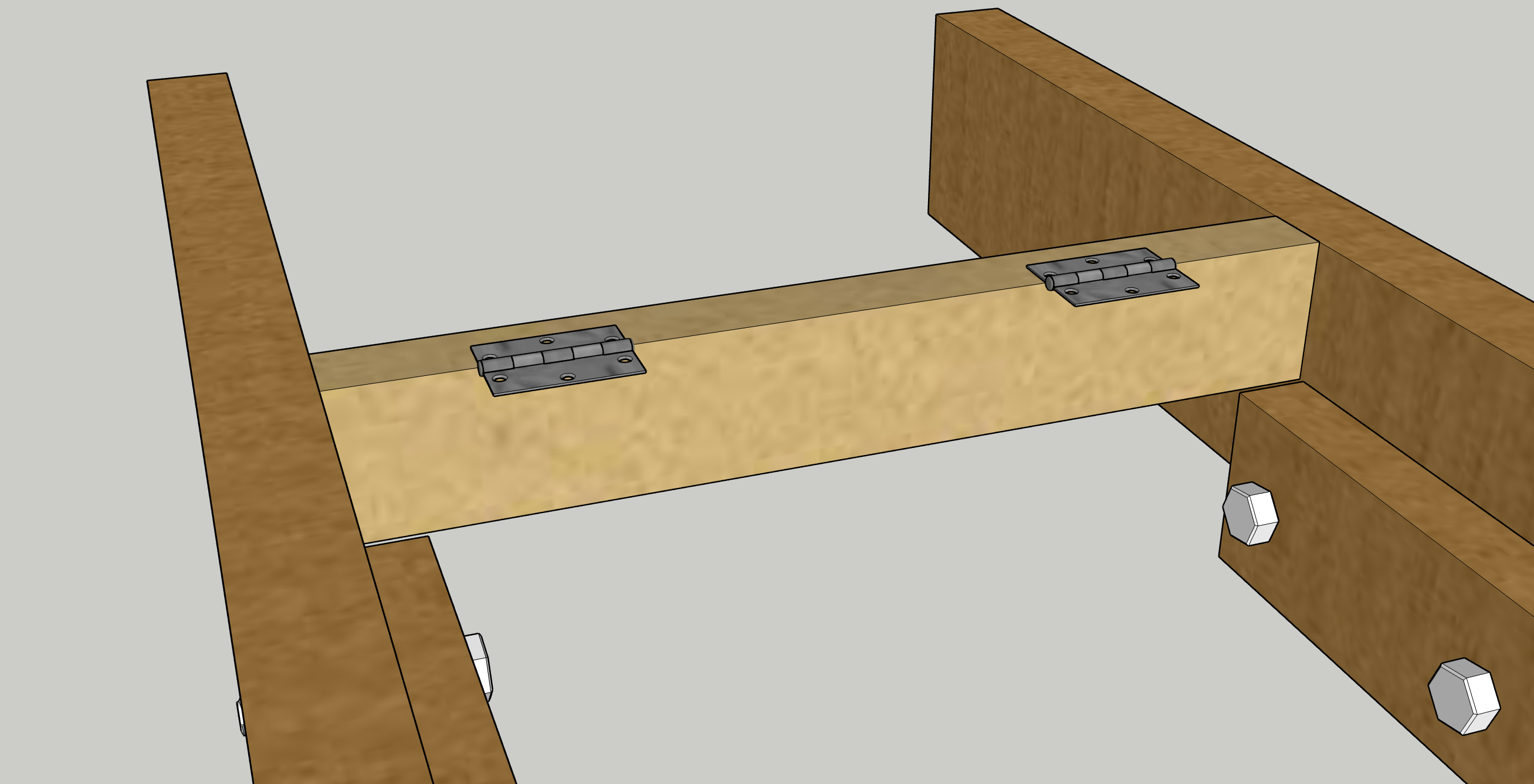

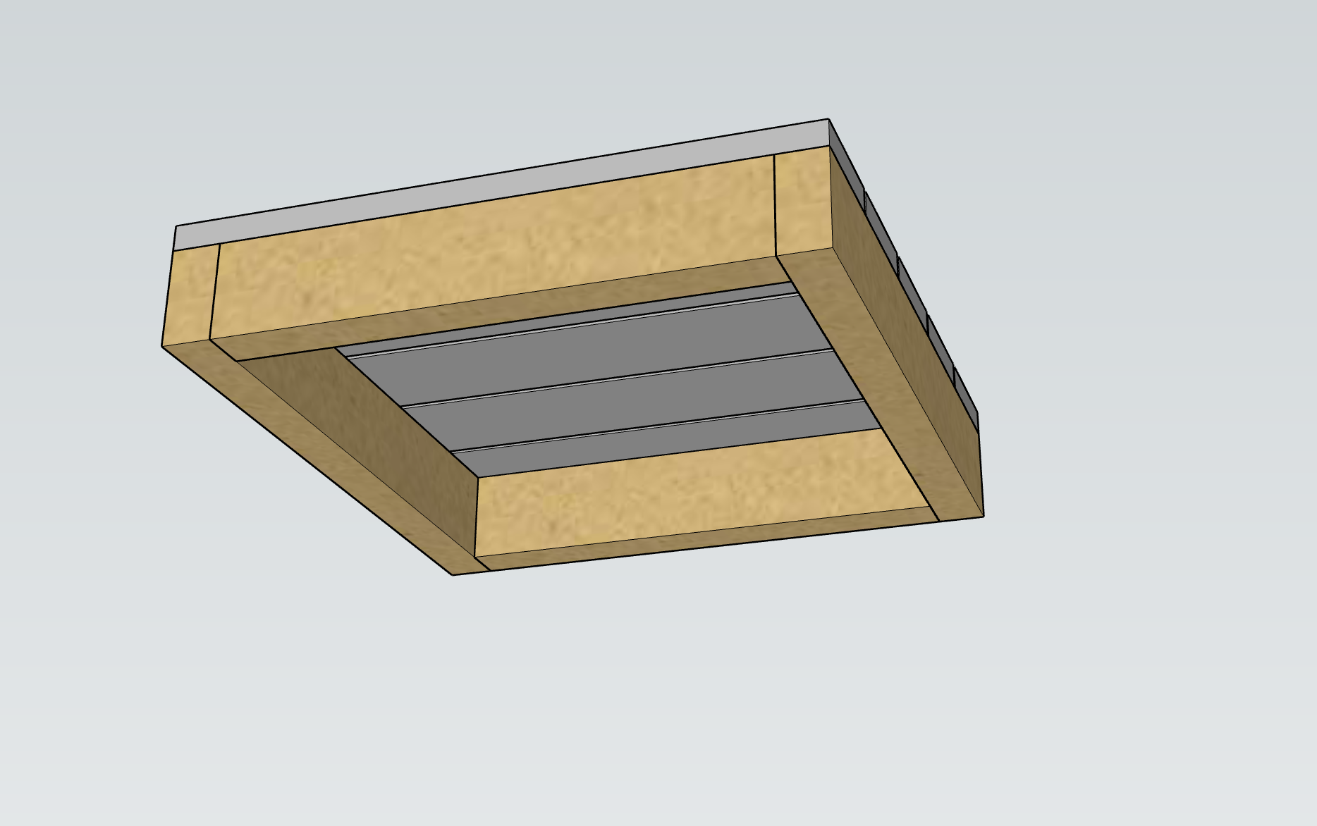

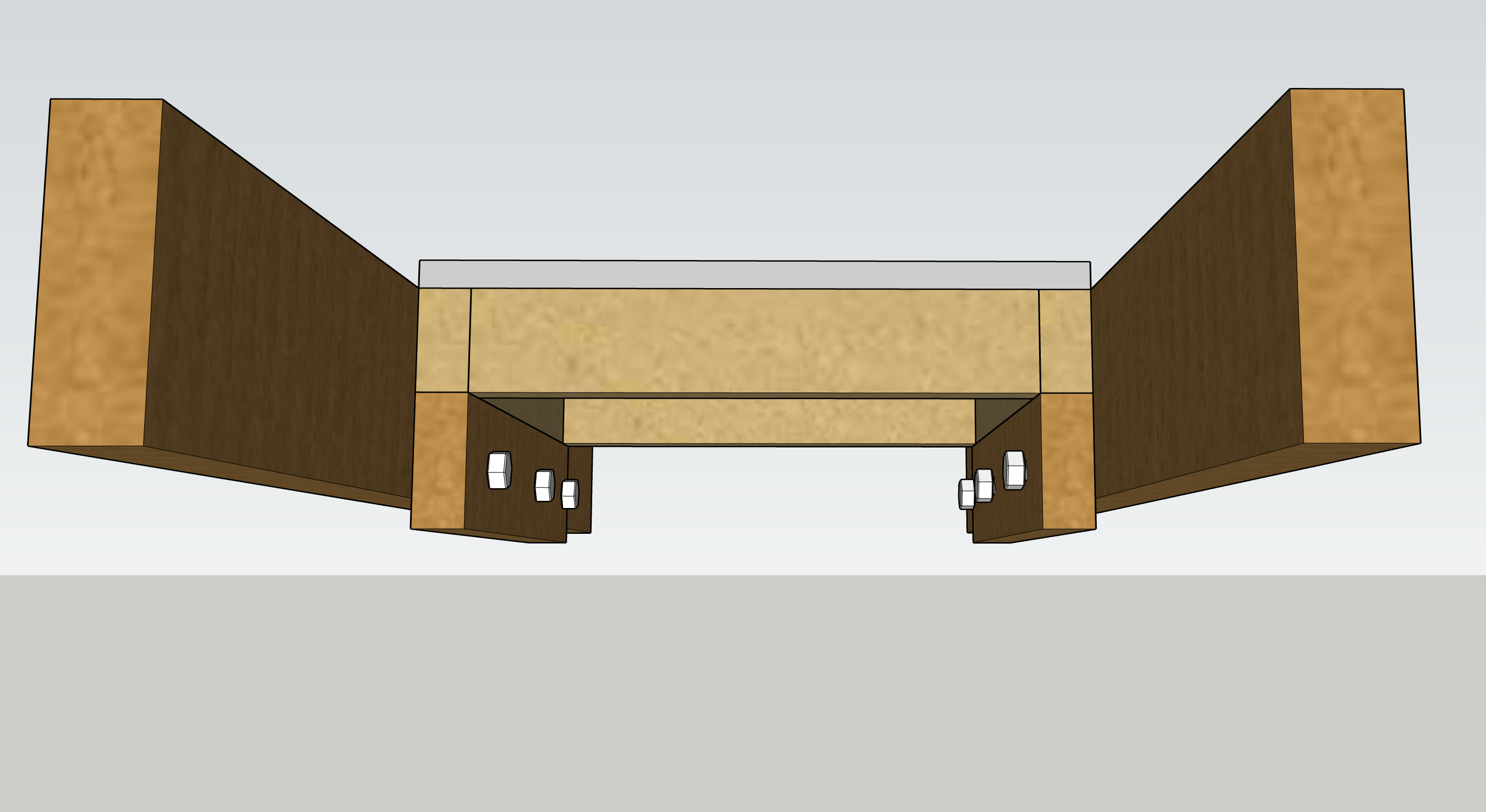

You'd have to start by building a basic timber frame that the decking boards will attach to. 70 x 35mm Outdoor Framing H3 Treated Pine should be fine.
We'd also have to attach some 90 x 45mm Outdoor Framing H3 Treated Pine to the decks joists. The frame of your trap door will sit on top of this when it is closed. It could be attached to the joists using galvanised bolts. This will ensure any load applied to the trap door is then transferred into the joists, ensuring it is safe to step on.
You will also have to attach some framing that runs between the joists to attach your hinges.
This design would ensure your trap door is well supported and safe to step on.

Hi Jacob, thanks kindly for the response and incredibly helpful photos.
This suits what I had in mind and looks achievable.
I don’t have access to the underside of the deck as it’s fully enclosed and the side beams cover majority of the fascia preventing any options for a side entry.
the joists look like they are around 360mm apart and appear to be around 50mm width.

Hi Jacob,

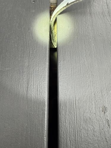

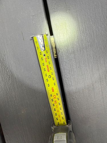

I tried the string approach but I don’t think I’m doing it right
After I took away the board thickness of 20mm, it looks like the joists look is only 80mm in height. Could this be possible? I will attach a photo
i might pull up some boards this weekend and get back to you
Hi @jd15,
It could be 90x45, which would make things a bit trickier, but it should still be doable.
