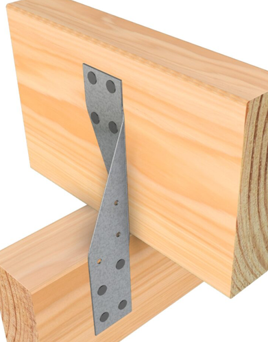

The joists could be fixed to the timber stumps with Pryda Unitie's

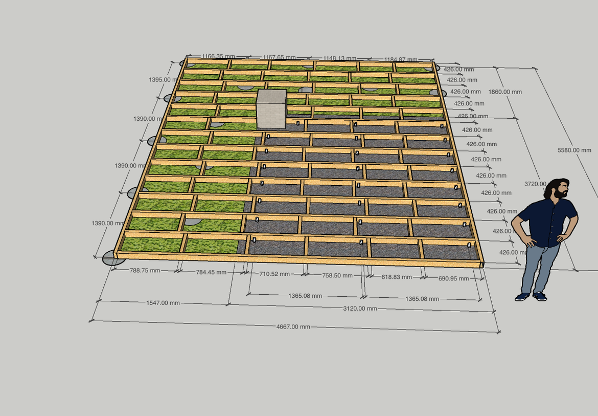

Hey @Dave-1 , @MitchellMc  and @Nailbag ,
Thanks so much for all the advice. I have been MIA working on my sketches. I have attached what I think will work in the space. I just want to double check that I have enough support with the joists or haven't over engineered anything.
You're right, once I sketched it out I got a way clearer picture in my head.

Evening @rwa1994
Much nicer and all of a sudden I am breathing easier :smile: Love that knowledge is confidance feeling!
Id be happy with that :smile:

Hey @Dave-1 ,
Thanks heaps. The concrete holes for the stirrups/posts are in an okay distance from eachother to support the deck so that it won't flex?
Thank you mate

Evening @rwa1994
Id say yes, and nice way to do it as well. I wouldnt have thought of that stagger and would have done a straight line :smile: Learn something new every day!
Re: How to build low level deck over concrete and grass?
That's looking pretty good @rwa1994!
