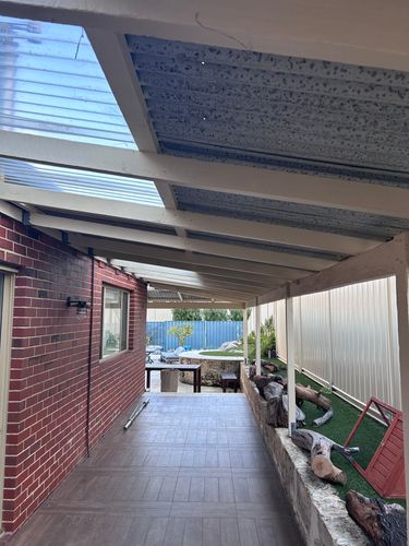

I have a wrap around balcony. A basic timer frame with corrugated roof. I’m looking at cladding the underside. The options I see are, cement fibre, pvc or marine ply.
im leaning toward Marine ply as it seems lighter than fibre cement and cheaper than pvc.
Anyone have any comments, thoughts or recommendations?

Could you share a couple of photos of the frame? That would help in working out whether it looks like it’s capable of holding sheets, and give a better idea of what product would be most appropriate. My leaning would be towards 4.5mm cement sheets, but confirming the strength of the structure first would be the safest next step. Let me know if you need a hand uploading images.

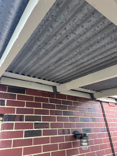

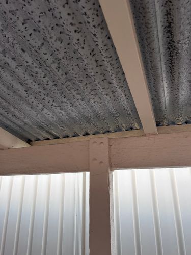

Only reason looking at doing it is because the corrugated is very old, stained by smoke is some places probably from a bbq . I’m thinking I should probably just replace the corrugated.

Just to offer another idea, it is possible to use a paint sprayer on the corrugated inner surface to revamp its finish especially if you are just after a cosmetic fix.
