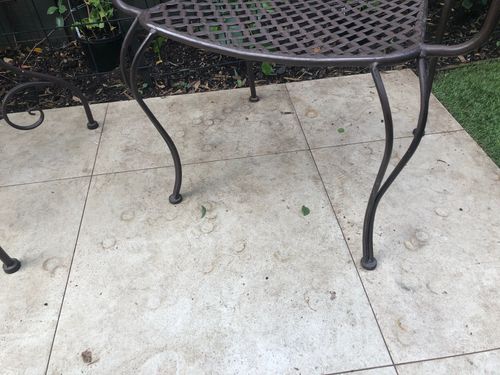

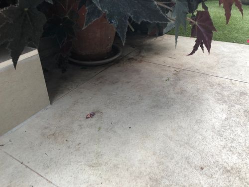

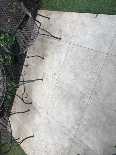

I have 1-year-old outdoor sandstone pavers that have been stained with plant litter and metal garden furniture (rust)
What product should I use that will not affect the garden plants and imitation lawn?
