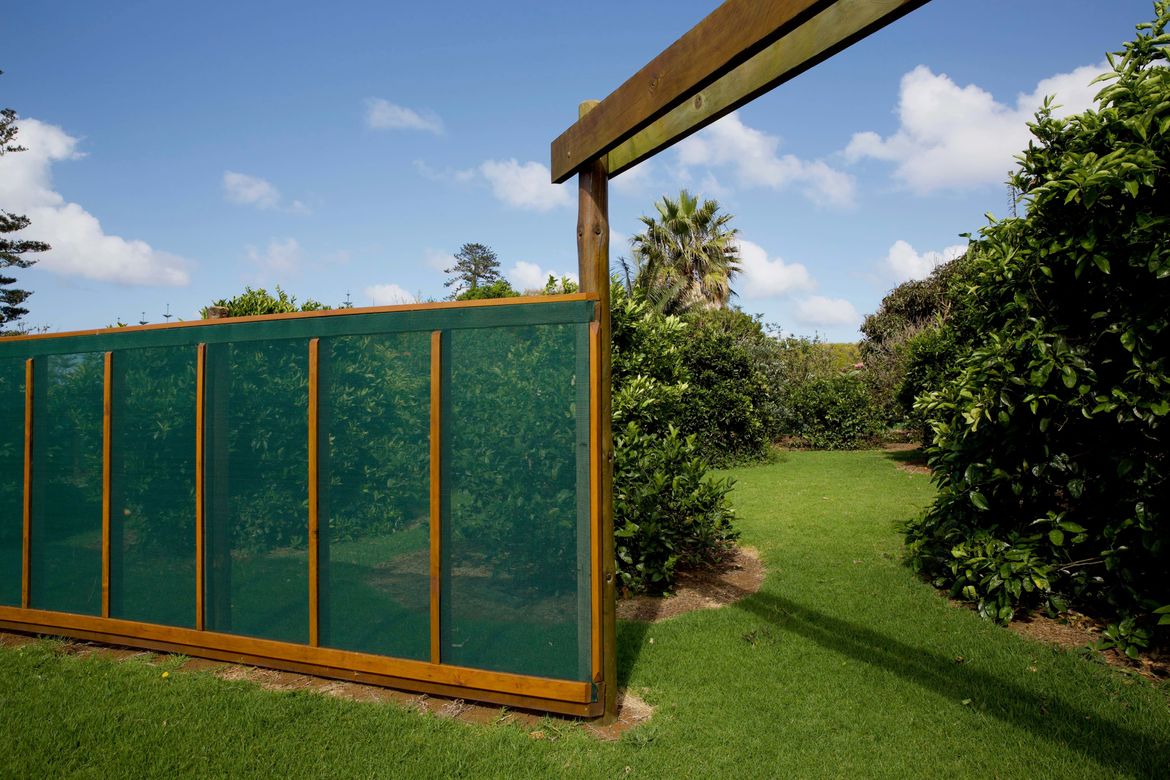

Late to the party @raymondo but the style of screen below can be very effective and done with very few posts.
I'm also a huge fan of clumping bamboos. They do not have aggressive or invasive roots and will fill up fast. Something like variegated dwarf Malay or Chinese dwarf would likely work there.
