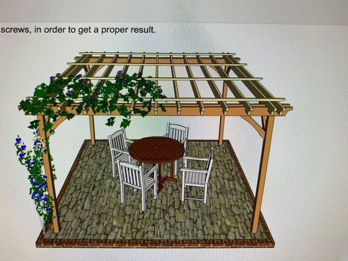

I would like to construct, DIY, a simple arbour/pergola It will be free standing, have no roof, just bearers and 'cross pieces' every 50cms then with very thin 'rafters' all to support plant vines.
3 metres by 2 metres by 2.2 m high using inground Pryda post anchors keeping the posts clear of the ground.
Posts, currently planned as (88X88); 3 metre bearers (138x42); 'cross pieces' questio0n below; thin rafters' (42x18) say 6 x 3 metres.
Understand that the length of bearers will be fine as the "cross pieces" will add strength.
Using to join the posts and bearers - bolts and nuts as advised
Advice would be appreciated on:
Questions are: # size of "cross pieces" planned every 50cm (138x42. OR smaller if practical??
#these cross pieces will be recessed to sit onto the bearers but I guess will need additional attaching #?best done with some hangers or screws or both?
#What size timber for braces at corners? # Do they need to be as big as the bearers or cross pieces?
#Can I buy Design Pine from Bunnings -special orders?
Thanks for your assistance
Rough plan photo below
What size braces (2 at each corner) 138x42 OR smaller 90x42?? what to use to fix the braces - coach screws , wood screws, smaller bolts and nuts?
The cross pieces will be recessed to sit onto the bearers but I presume will need additional fixing - would some style of hanger be right OR screws?

With the cross pieces, they have to be able to span the distance unsupported @BeginnerPaul. Provided its the 2000mm span, 140 x 45mm should be fine, but you couldn't go down to 90 x 45mm as it would bow over that distance.
If you are notching the cross pieces then you can screw through the top of them down into the beam. Joist hangers certainly would hurt, but your aesthetics might take a hit.
Braces at the corners could be done with 90 x 45mm.
We can order Design Pine, and we also have Woodhouse laminated and primed Pine in store.
Braces could be fixed with coach screws, but my preference would be bugle batten screws.
Tanalised 300g Clear Enseal Timber Treatment is suitable for your cut ends.
Any exterior primer such as Dulux 1Step would be suitable.

I appreciate your advice that Bugle Batten screws would be suitable for fixing the cross pieces to the beams/bearers. According to the plan Image, the cross pieces will be placed on their 42mm sides, and notched leaving say half of their 138mm depth available for screwing into the bearers' sides.
Question is what specifications (size, length/stainless steel) for those bugle batten screws?

I'd advise using the Bremick XTP 14g x 150mm T40 Stainless Steel 316 Bugle Batten Screws down through your cross pieces into the bearers, with 1 in each bearer totalling 4 per cross piece. I'd advise using stainless purely because the screw head will be facing up and is likely to have water pooling on it. The slight increase in the cost of stainless fixings is justified by their ability to withstand rust when consistently wet.
Use a Sutton Tools 5.0mm Long Series Jobber Drill Bit to drill pilot holes as screws of this size and length will displace a lot of timber fibres causing bulging and splitting if pilot holes aren't drilled deep enough.
Woodhouse produces 88 x 88mm 2.4m H3 LOSP Posts, 138 x 42mm H3 Treated Pine Primed LOSP and 42 x 18mm 5.4m H3 LOSP which would all be suitable for your arbour.
With your concrete footings, I'd suggest a week of curing time before continuing construction. After 7 days, concrete typically reaches around 70-80% of its full strength, which will be enough to resist any forces applied to it during the construction process. This will allow you to pour concrete one weekend and then begin construction the next weekend.

Post Anchors. - what specifications for the bolts and nuts for Pryda Post Anchor High Wind 450 x 90mm M12 ; how to choose the correct washers?
Posts to Bearers - what washers for the M16 x260 recommended bolts/nuts
Braces. - Plan to use bugle baton screws as recommended. Specifications please for screws as there re so many
Related Question: As the Braces will be screwed into the posts at 45degrees, would some screwing guide be useful?
Slats (3m parallel with bearers and across the cross pieces) - cross pieces will appear at ends and every 50cm along the about. They will be on their side. Purpose of the slats is to be the final timber to hold the climbing vines. Question is: how often to screw the thin slats into the cross pieces?
Related Question: what screws, spec, and stainless steel as will be facing up?
Timber Design Pine or Woodhouse: Is Woodhouse available at 90 x 42 4.8 metres for the braces? Is Woodhouse available at 42 x 18 6.0 metres for the Slats?

Post Anchors - I'd suggest these ZENITH M12 x 120mm Hot Dip Galvanised Hex Head Bolts and Nuts. There is no need to use a washer for this connection as the bolt head and nut will be tightening on the post anchor which will spread the load in the same way a washer would.
Posts to Bearers - I'd suggest using these ZENITH M16 Hot Dip Galvanised Flat Round Washers on the nut side only. This is because the cup head on these bolts is designed to spread the load in the same way a washer would.
Braces - You're aiming for the screw to be embedded at least halfway into the post. Depending on the angle of the brace, something 100mm long like these ZENITH 14G - 8 x 100mm Class 3 Galvanised Bugle Batten Screws will be fine.
I'm not aware of a jig that is adjustable to meet the angle of your braces. The trick to driving screws into angled surfaces is to predrill them first. Starting the drill bit perpendicular to your brace, drill a small hole roughly 5-10mm deep. You will then change the angle of the drill bit to run perpendicular to your post. The original 5-10mm hole will hold the drill bit in place stopping it from slipping down while you drill the pilot hole at your desired angle.
The thin slats should be screwed into every single batten. You can use Bremick 10G x 50mm Black Stainless Steel 304 T20 Trim Decking Screws. Looking at your picture, you will need 52 of these screws. This is the most cost-effective stainless-steel screw I could find that will give you enough screws.
Unfortunately, the 90x42 does not come at 4.8m, you will have to grab this 90 x 42mm 5.4m F7 H3 Treated Pine Primed LOSP.
Unfortunately, the 42 x 18mm 5.4m Moulding H3 Treated Pine FJ Primed 4 Edge Pencil Round LOSP only comes at 5.4m.
