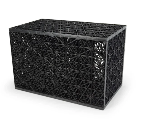

There is nowhere for the water to run off or collect to as it's in the back corner of the property. I have started digging and my initial plan is going to install 2x the following product in the pit, cover with geofabric and then backfill. Product states it can hold 252 litres of water. The only issue I have is the ground is clay.

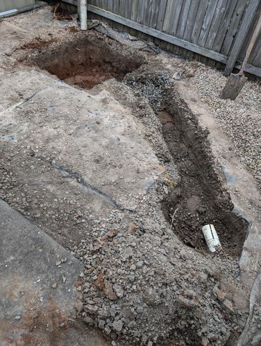

Pit i have started to dig;
Also, I would like an overflow to point somewhere so it does not back up the downpipe and into the roof space.

Thanks for sharing your question about your storm water overflow. Generally, this would have been an ideal solution to the overflow. However, due to the clay soil, I'm afraid the absorption rate will not be enough, and I suspect that the pit will overflow.
I propose examining the issue further and perhaps using an Everhard Series 450 Stormwater Pit Case Only in combination with an Ozito 350W Dirty Water Submersible Water Pump. Since there is no storm water overflow in the area, the hose from the submersible pump can be directed to the overflow closest to it.

With that stormwater pipe we can see how far away and height wise is the other stormwater that is plummed into the actuall stormwater?
The pit being in clay is just going to hold the water (unless you want a pond? and that could work with the submersible pump to keep the water level)
I have had to dig through a lot of clay for my stormwater pipes but consider it worth it and you certainly seem to like it enough to dig it out the way you have :smile: If you have a submerible pump you will have to factor in power for it or run it from a solar panel plus battery (always the issue if you have grey days and rain) If possible at all I would suggest to join up your stormwater piping as it will remove the pump from the equation.
Note you will need to cover the pipe in gravel when you install it, up to level with the pipe. This will stop the compression of that clay from constricting the pipe in the years to come.
