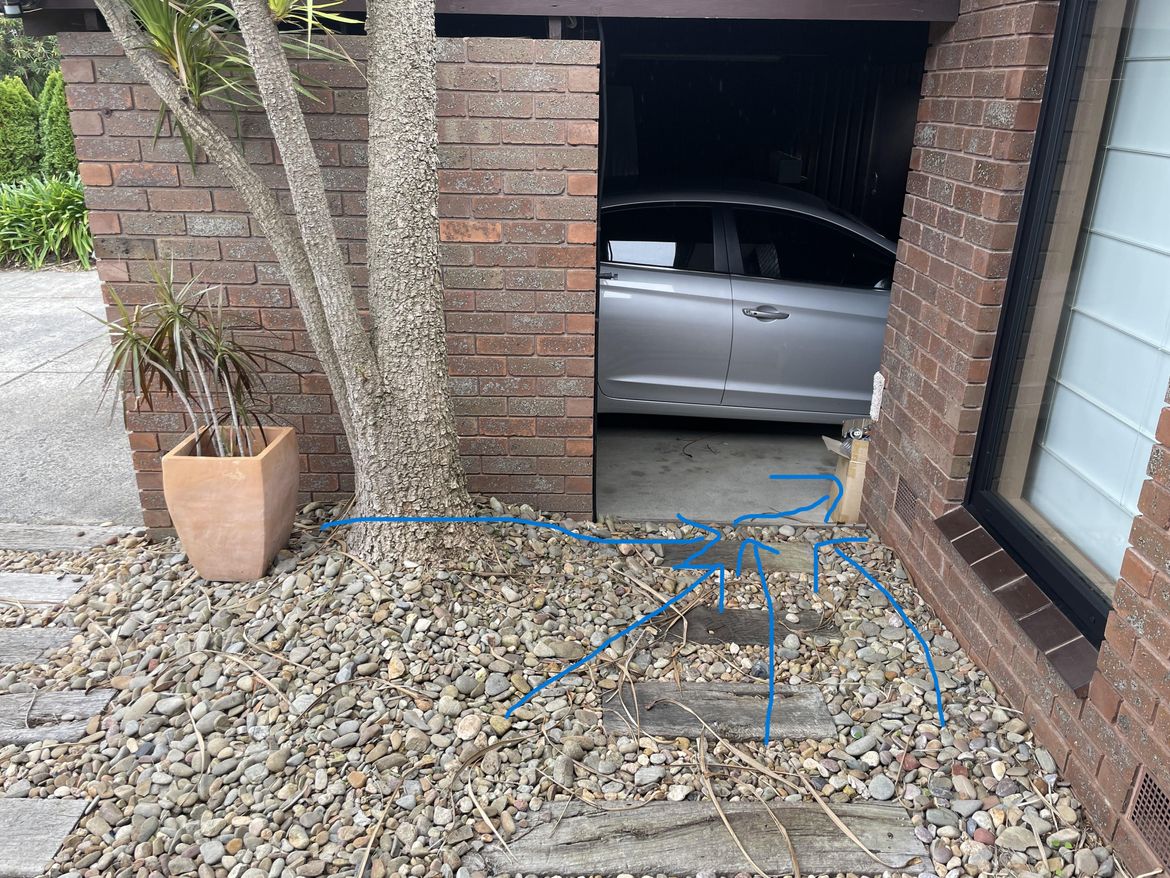

Currently, when it rains, due to the contours of the land beneath the pebbles, the water follows the blue lines on the photograph and pours into the garage and out the other side.
Blue arrows show flow of water into the garage during rain

My idea is to dig a small trench from the wall with the window, behind the tree, to the driveway where the reclaimed sleepers can be seen. The trench would slope towards the driveway and I would put flashing in it and a grid over it, or just a run-off pipe buried, so the water does not seep into the soil there, but runs down the driveway.

Your idea of adding a channel at the back of the tree is a good one. Just to add to your idea, I propose removing all the rocks in that area and re-levelling the soil so that the fall will go away from garage and to your front yard instead.
I believe that water through the years has washed away a bit of the soil and made it settle down and a natural channel has formed. In order to dress this, I recommend adding more soil and gravel and using a compacter to raise and level the low spots.
This will then force the majority of the water to go in another direction. Any residual water that does get through will be caught by your diverting channel and re-directed to the front.
