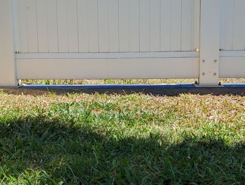

Hello,
I need help in figuring out a solution to fix this gap under my vinyl/plastic fence. It has a solid concrete base the whole length. The posts protrude from the base fence face of 40mm
Its to keep my dog from peering outwards and barking at the dogs walking by. (she must protect the yard of course) ha ha.
The fence gap is about 75mm and the fence length in total is roughly 16m including the posts. The lengths between the posts are 1980mm with one section being 1380mm.
Are there adhesive materials that will withstand the Far North QLD weather and heat that I could attach to the fence to fill the gap?
I'm open to drill in options also.
Thank you.
Justin.

So my first thought is not to try and attach anything sticky to the fence especially with the heat you guys get.
How about lenths of timber that fit under the fence between the concrete base and fence itself? You could notch either end so it fits around the posts even.
Second idea would be these guys custom concrete products 900mm straight tapered garden edge These also come in 600mm lengths. Also there are corners ect and just place (high side against the fence) them along the inside edge of your fence.
Third Idea is just your selection of smaller width pavers in a line next to the fence.

I agree with @Dave-1 on not putting anything sticky on your fence. I can only imagine the kind of temperatures you get when it's really hot. Because you have a 75mm gap, I suggest having a look at the Hyne Timber 100 x 75mm x 2.4m H4 Treated Pine Post Wet CCA - 2.4m. It is possible for you to cut this right down the middle to get more pieces in a single length. It will be necessary to spray seal the cut edge, but because it is H4 treated it can be installed near the ground.
Another product I suggest is Icon Plastics 150mm x 10m Slate Grey Garden Edge. You can push this plastic garden edging onto the topsoil and the top part can be screwed to the bottom of the fence. This should stop your guard dog from seeing anyone else on the other side of the fence. Its light grey colour should blend well with your fence colour.
