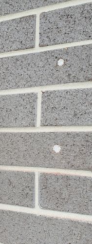

Thank you so much for your help! @MitchellMc
Had a crack at it over the weekend and I think it turned out well enough :smile:
Thanks again!
Re: How to fill masonry anchor holes in brick?
Hello @Unfortunate
Thank you very much for the update. Those masonry anchor holes look very nicely repaired. Please make sure to check up on them after a few weeks. Should any settling occur simply top up the patch so that it's nice and flat. This will prevent rainwater from pooling in the patch and prevent mould from taking hold.
