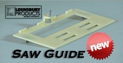

Hello, im newish here and wanting to increase the gaps in my existing decking as taking them up isnt an option and they are so close together that the rain just sits there
i found this saw guide for the bottom of circular saws and it has a notch that guides the saw in between the decking boards. has anyone found 1 of these in Aust and had success with it please?
Old post but just came accross it but I'm sorry no one replied to you about your question. Two years on, did you get something done to your decking?
Not sure how you managed to do the ends if the boards run back onto the house. Perhaps you could provide some details and or pics?

Hi Barbara, i didnt end up finding a saw guide, i just used my small ryobi circular saw which worked really well. it created just a big enough gap for the rain to now escape between boards. i just got as close as i could to ends then used small hand saw ![]()
