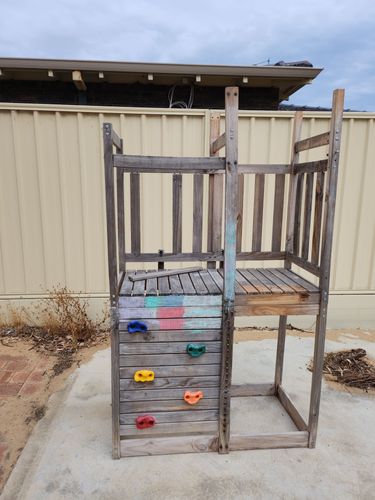

I recently received this cubby structure second hand and have since removed the roof as it was falling apart. The second image is what I now have left, the slide is detached as I plan to get a new one.
The wood is pine, and I plan to prime and paint it. it's not the most sturdy wood, although it's not rotting or falling apart, I was wondering what I could do to reinforce it and make it stronger. Would adding brackets help? or a product on the wood itself before I prime and paint it? It will be kept outdoors, so having it weatherproof would be helpful too.
Any suggestions on what I could do for the base to maybe make it more solid? add a wooden base inside as it's currently empty? the structure itself will be on concrete.
I also want to add some sort of roof replacement (doesn't have to be wood as originally) and considering PVC (from our patio as we are replacing ours) or a tough textile material (any suggestions welcome!).
Any other suggestions very welcome!
Thanks in advance,

I propose looking carefully at the strength of the cubby structure, specifically the timber joints. Does the structure lean when pushed around? Are there parts falling off or have rotted severely? Those parts that have become too loose will need replacing.
If the main braces or large timber parts that anchor the other parts together are loose, it will be necessary to install another piece either behind it or below it to secure the structure. If the timber part you are screwing into with the angle bracket is still in good condition, make sure that the screws anchor tightly.
Just keep in mind that you want this to be able to hold your child without any other parts giving way. I suggest sanding the entire structure before you paint it with a new colour.
In regards to the roof, I suggest copying the old roof shape and installing it in the same spot. For the base you can build a timber base and place the entire structure on top of it but just keep in mind that the end of the slide will need to be supported as well if the height of the structure changes.

With all the bolts/screws secure, can you move connecting parts? If yes, then replacing the screws with slightly longer and/or thicker ones as long as they don't poke through to the other side. Use galvanised right angled brackets and screws to provide additional support and strength when even larger ones are not successful.
Check the surface condition of all the timbers. I am confident that though the structure is pine, it will be treated pines, hence why its only blackened not breaking and rotting part being unpainted. With gloves on, feel for potential splinters especially on hand rails and the decking boards. Little bare hands and feet will be constantly grabbing and sliding on these areas, so it important to sand these area's smooth. replace anything thats splintering bad or splitting.
Seal the structure. With the roof off, it will make the job easier for you to get around inside the structure. Use a good quality exterior paint that has a built in primer (if possible) to save an extra coating. Apply 2-3 coats, The first coat will be the most time consuming as the paint will want to soak in. Then give it a touch up each year. have fun with colour too, especially if this is for little girls.
Replace the roof. If you want to make this an easy job, follow @EricL advice and repeat the same design. Re-purposing your better condition sheeting is a great idea. Otherwise consider dark coloured laser-light PVC sheeting. Dark to offer protection from the shade (its an open cubby so light isn't an issue) and PVC because it doesn't get anywhere near as hot as metal sheets and lighter to install.
Drainage. If the cubby is to sit on concrete as it is now, drill a couple of holes at any low points to allow water to escape. Put the hose in the base to check this. 12-16mm holes will work. I would do this even if you fill the base with sand. This won't be required if the cubby is positioned on the lawn.
Protection from falls. Consider using "soft-fall" mulch or rubber mats around the cubby for the inevitable falls.

Id suggest a few more diagonal stays are put in (more so then brackets) For instance I can see the two bottom parts of the posts on the right of the picture. If you went from the top part (next to the floor above) down to the bottom of the other post with a new post it would strengthen it immensely. same goes with the rear wall that we cant see. You can use timber or metal strapping but id prefer timber. I would even be explaining to your kids why it works :smile: (Love levers and angles and how they all work together)
With the roof as @EricL has suggested, same size makes life a lot easier. Id go with the smokey Suntuf 2.4m Grey Corrugated Polycarbonate Roofing as its lighter and will stop the rain. You could also go for shadecloth but then if it rains forgotten stuff inside will get wet easier :smile: Cant have that rabbit getting rained on!
Otherwise @Nailbag   and @EricL have mentioned all the other steps id be doing as well. :smile:

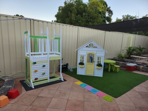

meli1
Re: How to fix a cubby structure?

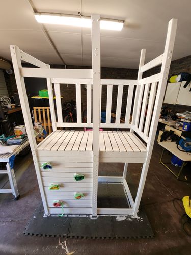

thanks everyone! 😊 @Dave-1 @Nailbag @EricL  I have since sanded and primed and started painting. The green needs a second coat, I am also adding some blue and purple sections for more color.
I have added some "feet" to help stabilise the base and have a new slide I will be attaching.
I also have some brackets I intend to add inside the structure.
sanded, prepped and primed:
feet added and partially painted:
The above photo is where I intend to keep the structure (minus the black mats that are just there to catch paint drips). What would you suggest I use for the base to help with drainage as we dont have any real grass in our garden? rain naturally drains to the left of the structure. I've seen some Jack Matrix grip tiles at Bunnings which I have considered may be solid enough? that with some astro-turf on top? I'm worried foam mats may not be very stable.
thanks again! more updates to come as I make progress (roof yet to be added, along with new slide and handle bars).

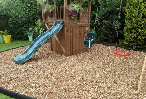

Looking terrific well done @meli1
I've built a few tall cubbies in my time and have always found "Soft Fall" mulch excellent. It's a soft natural timber fibre and doesn't get hot like most synthetic grasses and rubbers do. Plus they can give a carpet style burn if fallen on whilst running etc. Just Google "Soft Fall Mulch" in your area which comes from most good garden suppliers. Some even sell coloured mulch which is fun for the kids.
