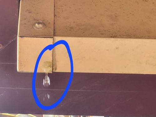

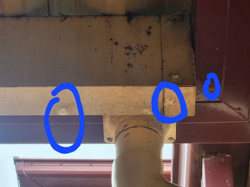

Hi everyone,
I have a section of my pergola (not sure what it is called) that drips continuously when it rains and continues for a few days after raining.

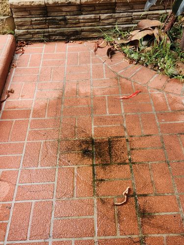

This causes lot of dirt to pool at both ends of the ground.
Any ideas on what I can do to stop this?

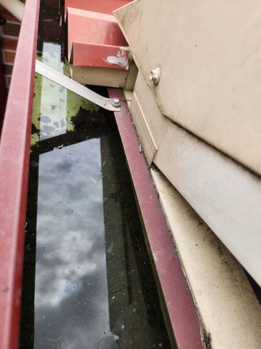

Re: How to fix a leaking pergola?
Hi EricL,
So I found a tennis ball stuck in the yellow pipe and the gutter had pooled water. Cleared the ball and it drained. Could that have been the culprit?

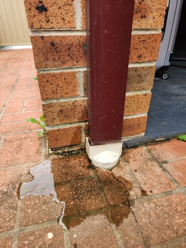

Also after it drained the downpipe released a lot of water from the bottom. Any ideas on how to fix?
That sounds like the culprit, @Karl92! The pooled water due to the blockage has allowed water to seep out the gaps in the guttering. Under normal circumstances, the slight leak to the gutter would typically go unnoticed. To resolve this completely, you can always run some gutter silicone along the inside seam.
The leaking at the bottom of the pipe is probably from the large amount of water being held in the gutter. Due to the flow, it's seeped out of the fitting at the bottom. It's likely nothing to worry about, and once again, when it's raining and the flow much less, you'd likely not even notice it.
