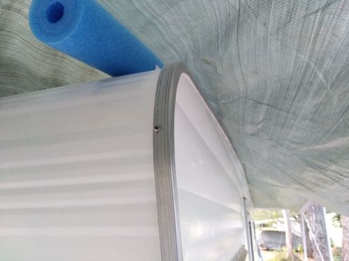

Regarding the screw, you’ve probably tried this for stubborn screws, but get your Philips head screw driver, slot it into the screw head and give it a few hard taps with a hammer, then try to unscrew it. Repeat if necessary. I also find, as odd as it sounds, sometimes trying to tighten it instead of loosen it will break that grip. Obviously don’t keep tightening it, but give it a try. Be aware that if you need to replace the screws they are Marine Grade 316 screws, not just any sort. I had to buy mine from a specialist fixings shop as unfortunately Bunnings didn’t have the required gauge and length of those screws. They do, however, have a good range of 316 screws for other parts of the van. Also, when reinserting the screws, make sure you put some sealant in the hole before the screw.
Looking at the damage to screw and metal in your image, it looks like you might be using a wire brush??? Not a great idea at all. Aluminium is very soft so scratches easily. Instead use a Josco nylon brush attachment on your drill. They’re in Bunnings in the tool section, and look like  red anemones. The nylon wheels will make light work of cleaning the old sealant off windows trims/J rails, etc, and you’ll be singing its praises like the rest of us.

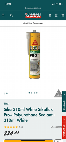

This is the Josco nylon wheel, and Sikaflex Pro which is a great sealant for the van.

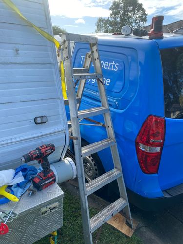

Thank you for the tips. I appreciate it. I have bought a gazebo and a very large tarp. I will now find somewhere level as my place is not. Below is not the best start to doing anything safe. This is me doing prep work, jammed between a work van, ladder on a piece of wood to keep it steady, my gear on the roof top of the van lol and the end product of me waterproofing it

Thank you for all the suggestions. That screw tested me big time. I did everything you mentioned and more. I even bought screw extractors. No luck, so a friend came over ( a builder) said to cut it off, which I did. The damage on the trim is from me trying to get the screw out. In regards to removing the silicone. I bought Josco nylon wheel brushes. What a game changer.  It is this forum I get the help to help me along. Thank YOU ALL

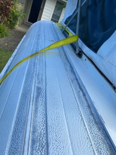

Looking at the photos I think you are in for a full roof restore to replace all the timbers and possibly new cladding.
I suggest you do a Google using 'EPDM Rubber Roofing for RV's'.

Respectfully, I disagree with Alan's thoughts on having to replace all roof timbers and possible cladding. I don't think enough information can be gleaned from the photos to determine that, and your cladding won't be affected by water ingress as it's aluminium, so no need to consider replacing that. It is a pop top after all, so the roof isn't actually connected to the van, except by struts and a vinyl skirt. It looks like it may be leaking where the aluminium is at the base of the pop top, but even so, I don't imagine all is lost.
If you methodically work your way around the van, removing trims from the corners, removing windows and door, and remove all traces of past sealant and replace it with new, you'll know your van is sealed properly. Additionally, rake out the joins/folded seams in the cladding, clean it up with acetone, then reseal those too. Very often those aren't sealed at all. It looks like the seam at the top, front of the van is the likely place where water's getting in. There's no point in doing half a job. As Alan says, if you do 'spot' sealing, even if you patch one spot, it'll be likely to leak somewhere else. Sealant on vans should be totally replaced every ten years. Given your van is a 1993 model, it should have been completely re-sealed twice by now, but obviously previous owners have just added more sealant onto the problem areas, which would never work.
