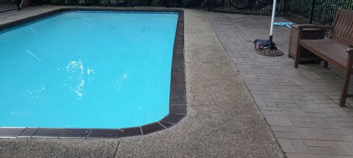

 Pool coping separated from paving, approx 25mm down one side. Fibreglass 40year old Pool. Any easy fix?

That is a fairly large curve to the coping. Are you sure it's just the coping, or is it also the fibreglass wall of the pool? I suspect it's the wall that is comprised, and it is pulling the coping away. I'd recommend you get this inspected by a pool specialist who will be able to advise on the best course of action.
If you can confirm it is just the coping, then the appropriate repair would be to remove it and then glue it back in the correct position. I don't believe it would be an easy fix, and filling the gap will likely only disguise the issue at hand.

Thanks Mitchell for your advice.Can you give me another name for pool specialist as not  sure what to look under.

You might also like to search for pool repairs or pool restoration @ken270.
