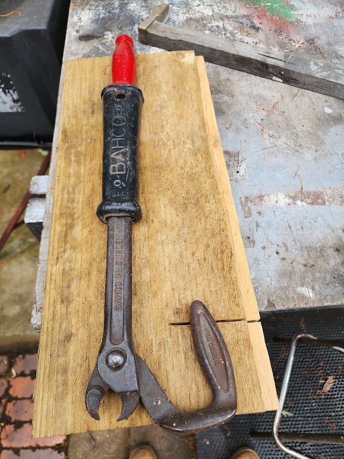

It's hard to tell from your photos @ezzie  - but I think I can still see many heads intact?
And a small ring of wood rot around each one.
But the Bahco doesn't need the head intact to extract the nail.
I don't know what length size your nails are, but this is a 60mm experiment...
With a bolt-cutter I cut the head off.
The inked ring sort of represents the 'rot'.
You can see the impression the jaws make - but considering the rot - tolerable?
Easily removed.
Generic brands are available on the net.
At the end of the day @ezzie - it's just a thought.
