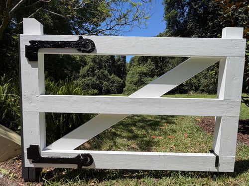

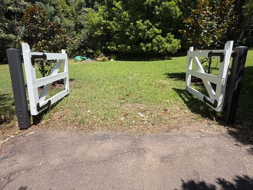

Re: How to fix rusting farm metal gate hinges?
Hi Jacob and workshop team.
Farm gates now complete.
We applied all your advice and regarding the progressive metal and timber treatment steps.
Check out pics.  Many thanks.
Hi @David4321,
It's fantastic to see your completed restoration. Your farm gates look wonderful.
I am glad that I was able to help in a small way, and I hope they serve you well for a long time to come.
Thank you for sharing and congratulations on a job well done.
