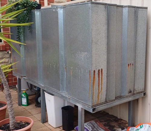

I have a rainwater tank on the patio of my house. The pump system is working well, but the tank has some small holes that have become rusted. I would appreciate any advice on how to repair them. Is it possible to fix the holes and rusted areas, or is replacement the only option?
Re: How to fix small holes and rust in a rainwater tank?
Hello @giomoes
Welcome to the Bunnings Workshop community. It's sensational to have you join us, and thanks for sharing your question about your water tank.
Before you make any repairs to your tank, I suggest having a quick look at your docket to see if the tank is still under warranty. If it is, I suggest calling the manufacturer and filing a claim for repair.
However, if the tank is no longer under warranty, I suggest cleaning the tank of rust and removing as much of the rust flakes as possible. Once you've cleaned the surface, I suggest using Selleys 110g Knead It Aqua Epoxy to cover the holes. My best advice is to allow the water to go down in the tank so that there is no pressure on the putty plugs you'll placing on the tanks.

Hi giomoes,
I suspect something on the inside is causing that rust and likely the distinctive rust line is all the way around the tank.
Can you access from the top to check inside and if needed drain the tank below that rust line and hopefully take some photos.

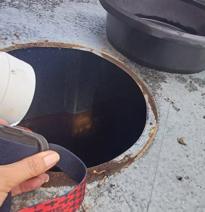

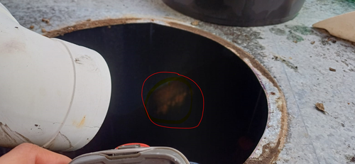

Hi AlanM52,
Thanks for the suggestion. I looked inside the tank from the top and snap the below photos.
The water level is above the holes. Additionally, the holes are located within the circular area, and the issue appears to be there all over the tank. It seems that something has formed or grown on top of the holes from the inside.
Hello @giomoes
Thank you for the extra photos of your water tank. Let me tag @AlanM52 to make them aware of your update. It appears that there is corrosive damage inside the tank as well. For long term repair, I propose engaging the services of a professional that deals with water tank repairs. The most likely repair option is to empty the tank and coat it with a potable safe sealer that will protect the steel tank and still allow it to hold the water within.

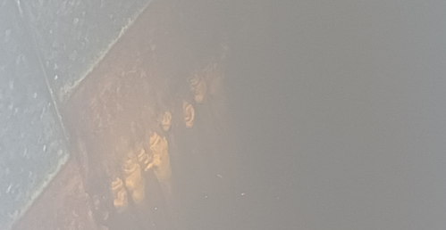

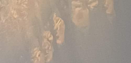

Hi @giomoes,
You did a great job taking the photos and highlighting those areas of interest.
That could simply be corrosion but why at the same height all around?
You really need to drain the tank below the rust line for better inspection but... if you are reluctant at this stage there is another option.
Endoscope inspection camera.
https://www.amazon.com.au/endoscope-camera/s?k=endoscope+camera
Carefully tape to a stick back from the camera over a distance of about 100-150mm in three places to reduce cable stress.
Cheers
