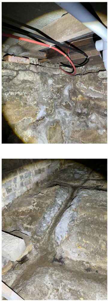

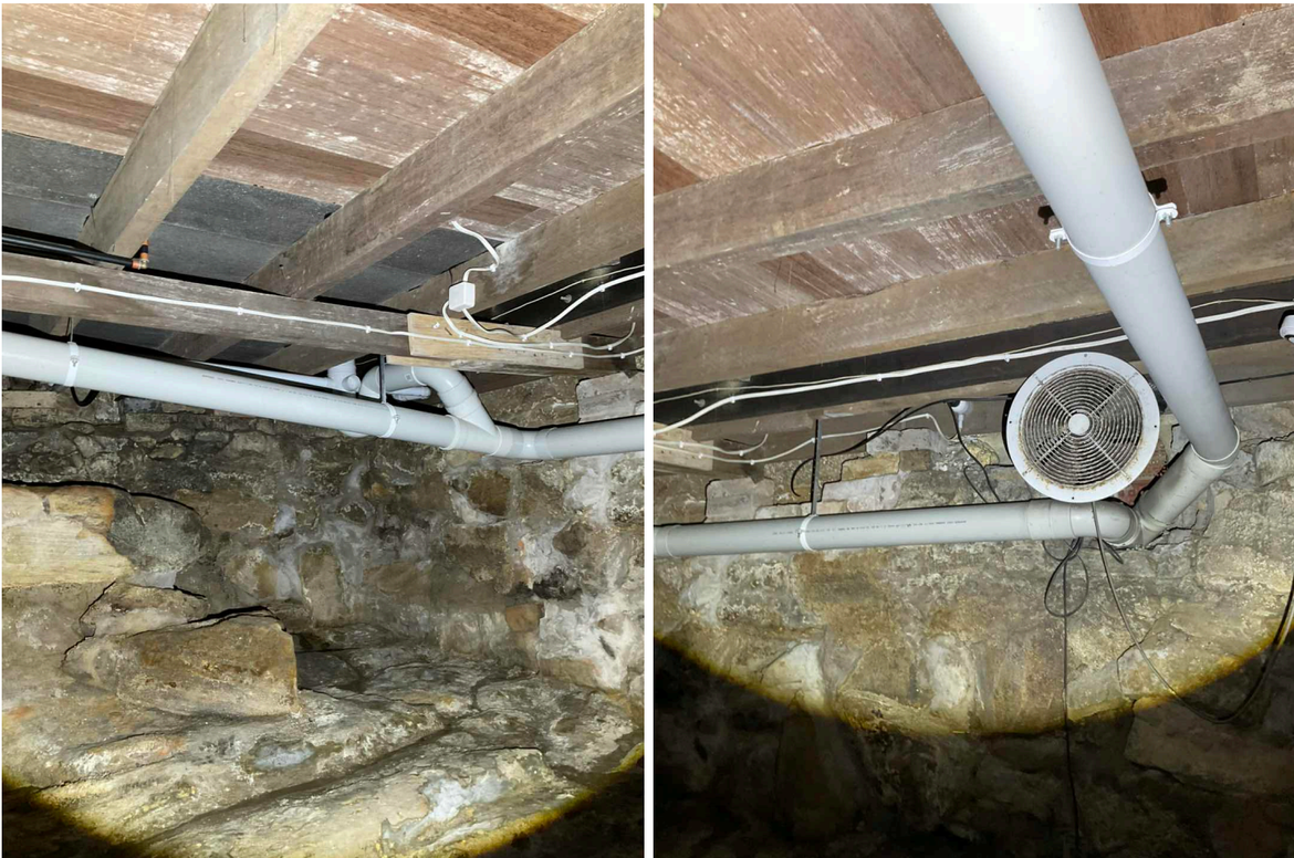

We acquired an old terrace house from my dad's estate, and there's dampness in the sub-floor soil. It looks like some of the timber also has fungal decay that will need to be replaced.
We're about to identify any potential leaks and fix that up first. There's no smell under house apart from dampness diagnosed during building inspection, so I'm ruling out sewerage. What else should I be looking for when identifying source? Also, what are good options to improve ventilation? we have a small ventilation fan, but likely need more solutions.
solutions to fix and add better ventilation? Screenshot 2025-10-23 at 9.58.30 AM.pngScreenshot 2025-10-23 at 9.58.13 AM.png

Many areas under homes naturally retain some dampness, so a slightly moist sub-floor isn’t immediately a cause for concern. Standing water or persistently wet patches, however, do need to be addressed. From your images, there don’t appear to be any overly damp areas, though there is some moisture migration into the timber bearer, as seen on the wall in your photo. Installing a small flashing under the bearer could help prevent moisture from tracking up through the brick.
When identifying the source, check for plumbing leaks, gutter or downpipe issues, subsurface water entry from surrounding soil, and any roof drainage problems that could channel water under the house.
Improving ventilation is key to managing dampness. Upgrading your existing fan is a good start, but adding passive vents along the sub-floor perimeter and ensuring airflow from one end to the other can significantly reduce moisture. If there is no active water pooling, these measures will typically resolve most dampness issues and help protect timber from further fungal decay. Is your current fan venting to the outside through ductwork?
You could also look at adding a waterproof membrane over all the block work, which will help prevent water weeping up through it.
